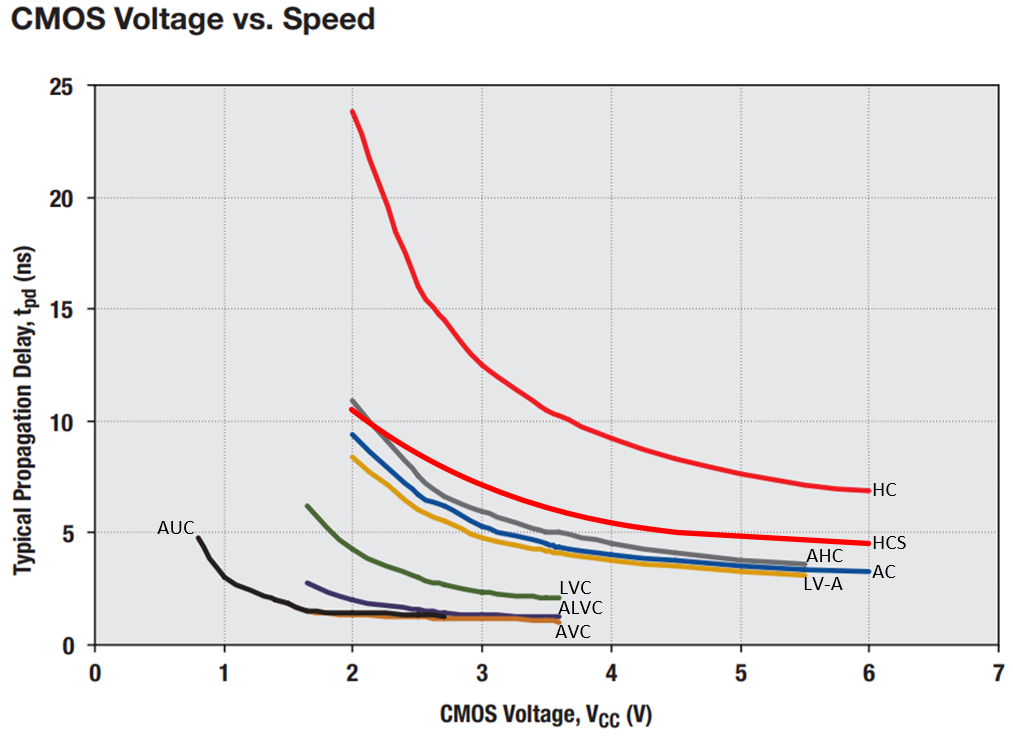

Is there have typ. tpd information can share to us? Thanks!
Hi Jeff,
We do not have any specific data we can provide for this, but please see the graph from this FAQ: (5) [FAQ] What is the typical delay of a logic device in a particular logic family? - Logic forum - Logic - TI E2E support forums
At 1.8V, your typical propagation delay will be 5-6ns.
