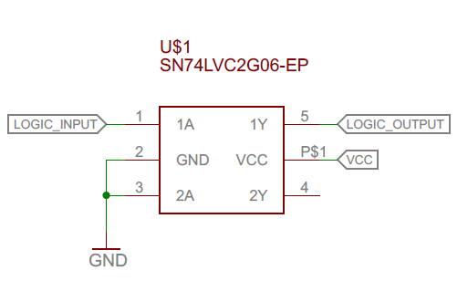

I am trying to use this inverter but have no luck with getting anything from Y1. When the 1A is low, I get no output. My VCC is at 5.08V, Logic input when high is 3.6V when low is 0V. Any suggestions?

This is an open drain part and will require a pullup resistor on the outputs to go high.
You could use the SN74LVC2G34 if you need the part to drive high and low.

Wow, thank you, I am embarrassed, I should read the title on the spec sheets more often.
