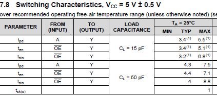

These datasheets show min and max value of tPLHD and tPHLD(tPD).
So, do you have these typ value as the reference?
Because there is the large difference between min value and max value.
<Question2>
Only SN74LV125A has tSK data.
The datasheet shows that skew tpHLD-tpLHD is max 2.0 nS.
So, does it include following conditions as example;
-tPLHD : 13ns
-tPHLD : 11ns
<Question3>
SN74LV14APWR, SN74LVC1G240 and SN74LVC1G126 don't have  tSK data.
Do you have these?
