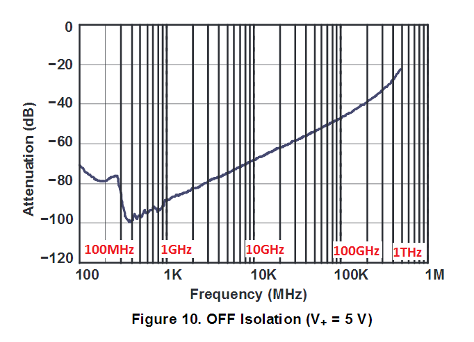

The datasheet (P.14) of  Figure 10. OFF Isolation (V+ = 5 V) describes Frequency (MHz) and scale is 100,1k, 10k, 100k and 1M.
This means 100MHz to 1GHz.
Is it correct?
    The graph says the following: 100MHz, 1,000MHz, 10,000MHz, 100,000MHz, 1,000,000MHz:
    Shinichi1 said:
    OFF Isolation from 10 to 100MHz
    There is a value given in the datasheet for 10MHz: -68dB.
    From the graph you can see that it is about -71dB @ 100MHz.

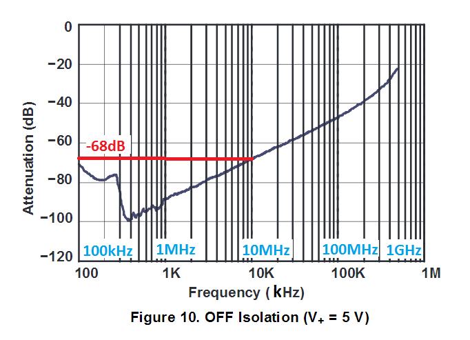

  • Hi Dennis ,
    thanks for your inputs . This looks to be typo on the units on the x-axis graph to me.
    It needs to be kHz and not Mhz to me. Same applies to the bandwidth graph as well.
    I will make a correction request for the datasheet .
  • When editing the graph I first thought that testing the device with 1THz is questionable. The bandwidth is 400MHz. But who knows what TI has in it's labs...
    But after a second look you may be right - the given -68dB at 10MHz fit quite well if you replace MHz by kHz:
    Dennis
  • Dennis ,
    I was baffled when I looked in the graph too . This was released long back before I joined but checking into the char data , the preliminary datasheet had the graph titles and then the plots were added later but never checked back into the units. comparing the numbers on the spec and the graph made sense to have kHz and all fall into place.

  • hi Shinichi san ,
    The data I see doesn't have the numbers for 10kHz , The graph starts from 100Khz .
    the crosstalk at lower frequencies should be minimal <-95dB.

  • Hi Shinichi san ,
    sorry , I must have referred to graph from another device.
    The information is not available to me in the char report ; and I wouldn't want to mislead the customer with my estimation. It looks like a -20dB /decade curve ideally and at Dc it should be completely isolated . I don't completely understand why the 'V' curve , could be limitation of the measurement meter itself.

  • Most of the SPST switches I checked has the offisolation measurement starting from 100Khz but nothing lower than that .
    The lower the freq , the lower is the crosstalk (gets better) . following a -20dB /dec curve , I would estimate the 10-100khz would be between -90db to -120dB.
