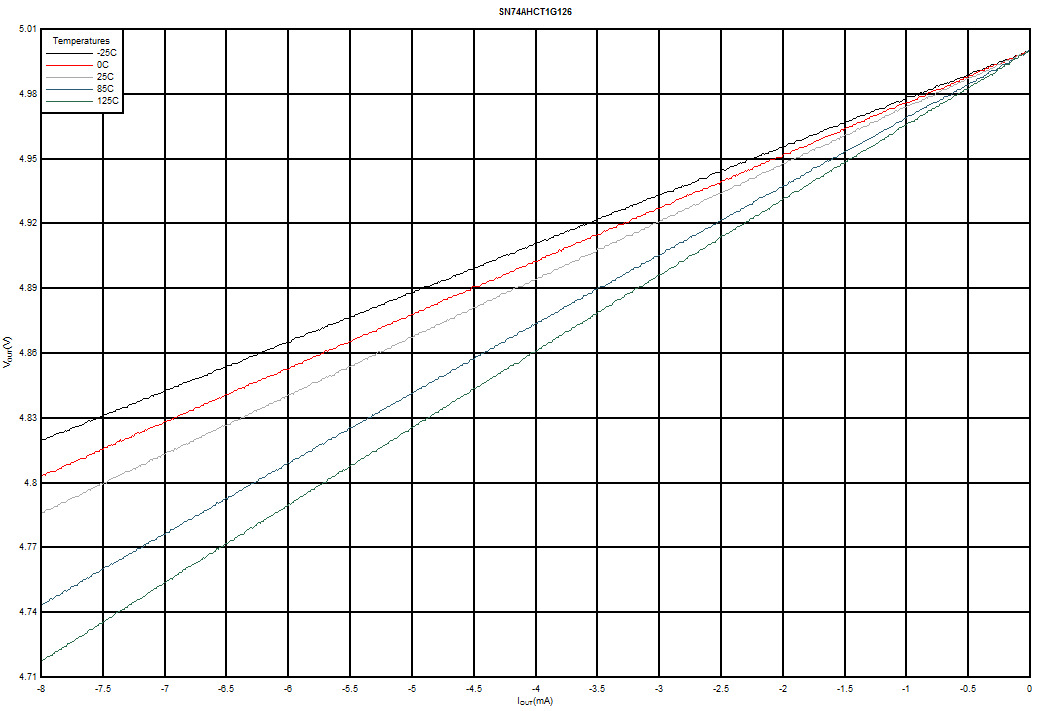

Other Parts Discussed in Thread: SN74AHCT1G126

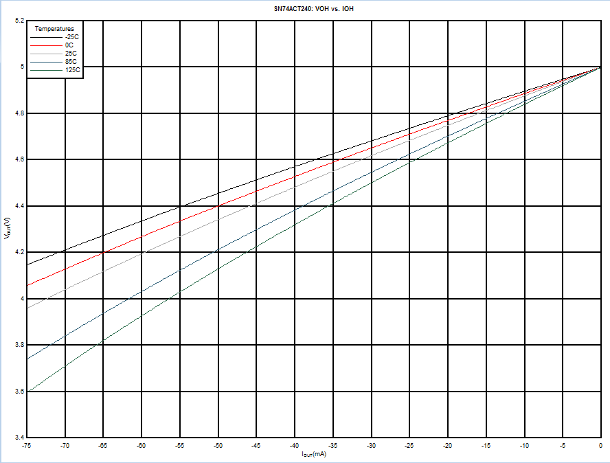

There's a WW motor drive maker where they request to get the curve plot of the VOL vs. IOL and VOH vs. IOH at -25℃, 0℃, 25℃, 85℃ and 125℃.
Device: SN74ACT240PWR
Customer: WW Motor driver based in TW
End-equipment: Servo Motor
Application: Line driver between MCU and IGBT driver or Current sensing OP.
Power: 100W-20KW
Please help on this information.
