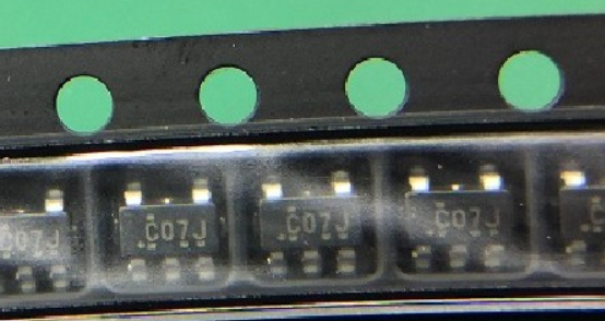

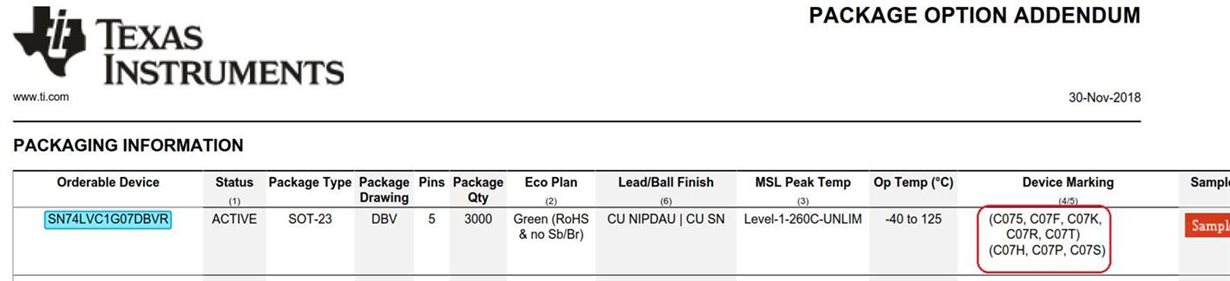

In the datasheet, the description of marking is as follows:
But what we're getting is as follows: C07J
Can someone help me with this problem?Thank you very much!
I can't explain this problem to the customer.Is there a better way to solve this problem?
Thanks always for your kindly help!
The top side symbol is now updated into the datasheet.
Thanks for your patience, let me know if any concerns.
