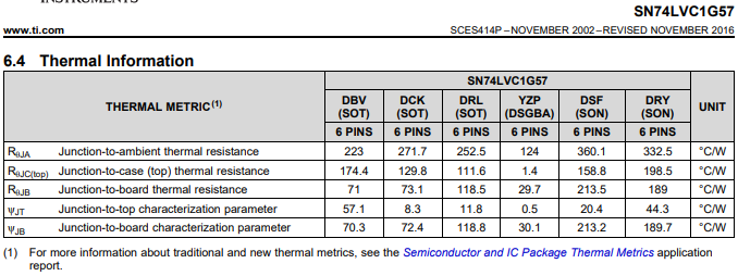

We are using SN74LVC1G98DRYR in our design. we need Juction-to-Ambient/case  thermal impedence for "DRY" package. This is not given in the datasheet. can you please provide this information.

    I can submit a thermal modelling request to get these values for you, however the soonest I would expect results would be about 2 weeks (4/18).
    If you need something sooner, you can use the thermals from the SN74LVC1G57 for an initial estimate:
    I would expect that under normal operating conditions the thermal rise of this device would be extremely minimal, however if this estimate gives you reason for concern, we can submit the thermal request and get more precise values.
    If this resolves your question, please click the green "this resolves my issue" button -- if you would like me to submit the thermal request, please reply to this thread.
  • Thanks for the reply,
    I will use the value you have shared for estimation. And wait for exact values from you.

  • Thanks for getting back to me. I will submit the thermal request and we can expect results in about 2 weeks.
  • Hi Kranthi,
    Please see the below values:
    Result- Theta JA-High K (standard datasheet value):
    337.9
    Result-Theta JC, top (standard datasheet value):
    234.1
    Result-Theta JB (standard datasheet value):
    209.4
    Result- Psi JT (standard datasheet value):
    63.7
    Result- Psi JB (standard datasheet value):
    209.2
    Result-Theta JC, bottom (standard datasheet value):
    n/a
