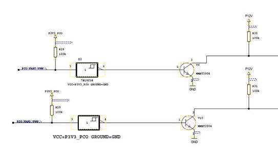

We use an SN74LVC14APWR as FAN PWM control circuit, we do not add the current limitation resistor between 74lvc14 output to transistor (V9). And the output of SN74LVC14APWR will be fixed to about 1V,could you help let your R&D  evaluate the risk of this application? And could you share the internal block circuit of SN74LVC14APWR for review?
  • Driving small MOSFETs without a resistor is fine. Driving BJTs is likely to exceed the absolute maximum ratings and burn out the output transistors.
    Please show the schematic.
  • BJTs spec as below:
    schematic:
    PCO_FAN0_PWM is always 0V is worst case, then the BJTs is always driving. Ic current of BJTs is about 0.12mA and plus an current from FAN module. we are requesting from FAN vendor. and Ib current is not measured, we are plan to capture the thermal image by camera, to see the temperature rise if over spec.

  • Hi Clemens,
    please kindly check the schematic and BJT datasheet below. In my opinion, the Ibias current is very small, it should make no difference to use a small  resistor(below100ohm) or not. The current is only 0.1mA, It only work when the BJT is damaged, but you know the source side also has the current limit function to several mA. Could you please double check the risks? Thanks.

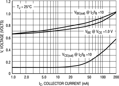

  • This is the VBE(sat) curve of the transistor (when IB is forced to be 1/10th of IC):
    These are the output voltages of an LVC device:
    A saturated BJT does not limit its base current. An LVC CMOS output cannot protect itself and must not be short-circuited.
    The transistor has no specification for such high base currents, but I'd estimate that these curves intersect at roughly 80 mA, which exceeds the SN74LVC14A's absolute maximum ratings.
