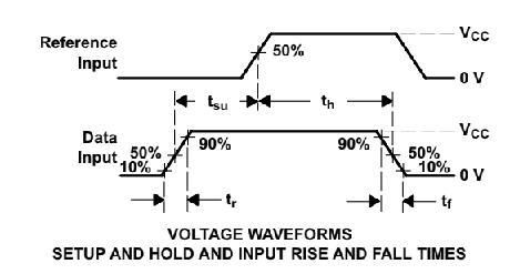

By the way, I also want to know what the third waveform mean for? Is it mean input signal should be ready (finished setup) before CLK edge signal?
What' the reference input mean for?

    No you should not add a capacitor, i would recommend looking at the timing requirements as these may give more details to work with.
    The waveform is just an example to show how setup and hold times are measured as well as rise/fall times. Its not info on application.

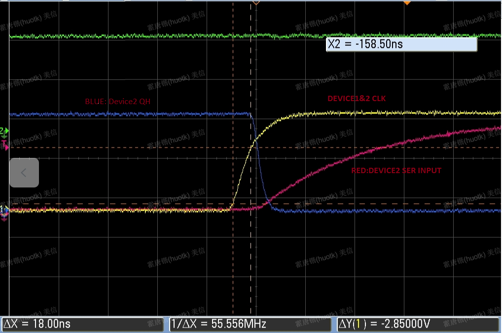

    I do still not figure out the timing requirement in datasheet.
    What I want to know is if the SER input signal rising edge is much slower than CLK input signal.
    Or on the other words, the device received the order from CLK to shift the SER signal/data into the device before the SER signal buildup properly.
    Like below waveform:
    As in cascaded configuration, DEVICE1 QH output signal buildup for device2 SER input at least for tpd delay even without the cap.
    How this device make sure that SER input signal already buildup when the CLK edge signal comes?

  • Have a look at the logic diagram (figure 3). The connection between the first device's QH output and the second device's SER input is exactly the same as the connections between the internal flip-flops (which also share the CLK signal). At each clock cycle, each flip-flop receives the previous state of the preceding flip-flop. The tpd value tells you how long you have to wait before you can send the next clock.
    Connecting two devices together creates a simple 16-bit shift register; the SN74HC165 was designed to work this way.
    Please note that the minimum fmax and the maximum tpd pretty much correspond with each other; if your circuit slows down the SER edges (i.e., increases tpd), then the frequency that you can use decreases accordingly.

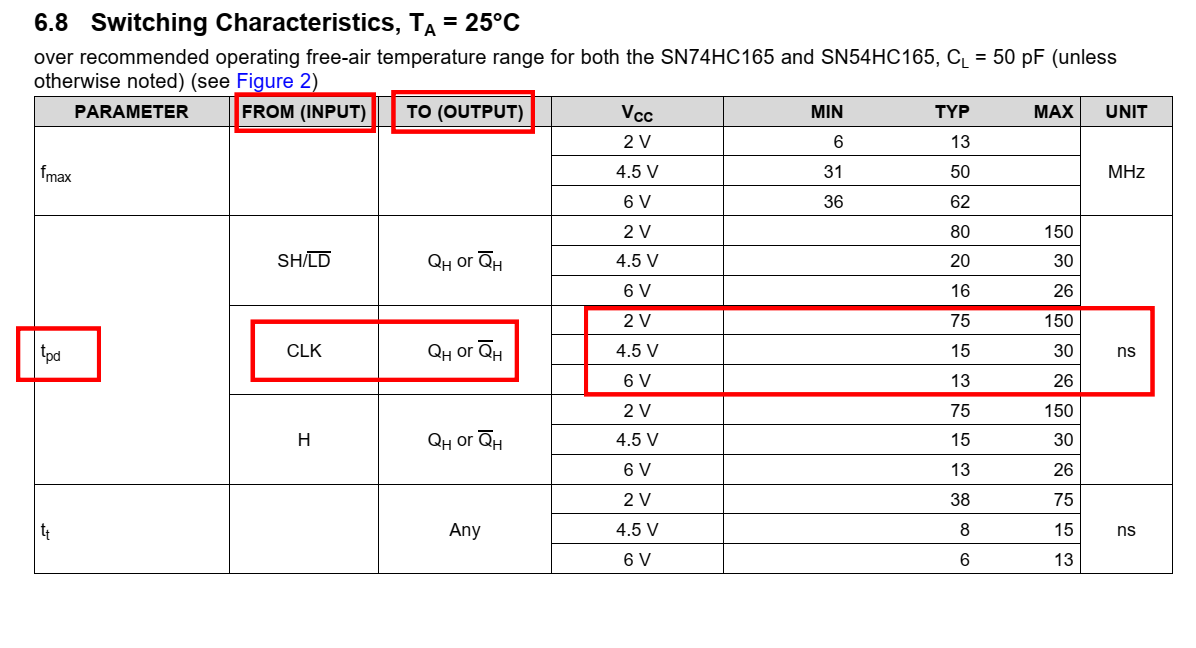

    I also want know after the device received an effective CLK edge signal and start to shift the input data from SER pin, the needed setup and hold time for sample is at least 15ns base on below datasheet spec is that right?
  • The propagation delay time plus the set-up time must be shorter than the clock cycle. (This is an restriction on the frequency you can use.)
    The propagation delay time must be longer than the hold time. (This is a property of the device itself.)
