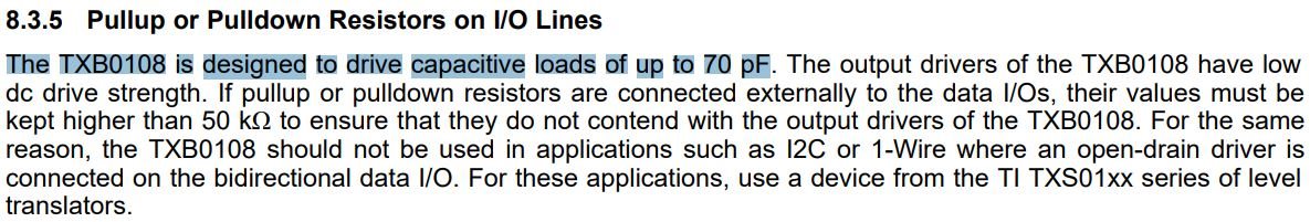

Could you please share the driving capacitive load ability of this device?
I could not find this in the datasheet. I only found a CL in figure3, but it seems not matching the driving ability.
From the datasheet of TXB0108 has mentioned this value
