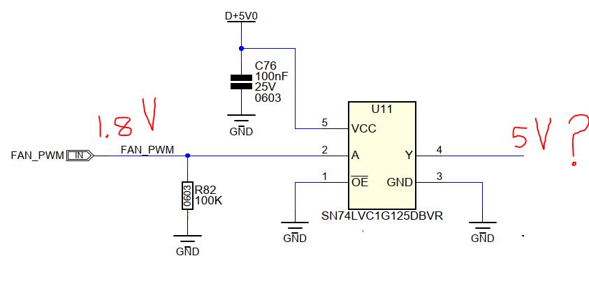

I have a voltage level translator design for SN74LVC1G125 but it is not working. From the datasheet it seems that the minimum VIH input should be at least 0.7V x Vcc and therefore the 1.8V is to low when Vcc = 5V. Please confirm if my understanding is correct?
What other single supply device can I use that is footprint compatible with SN74LVC1G125?
If there is no single supply footprint compatible device, what other part can you recommend I use for this design?
