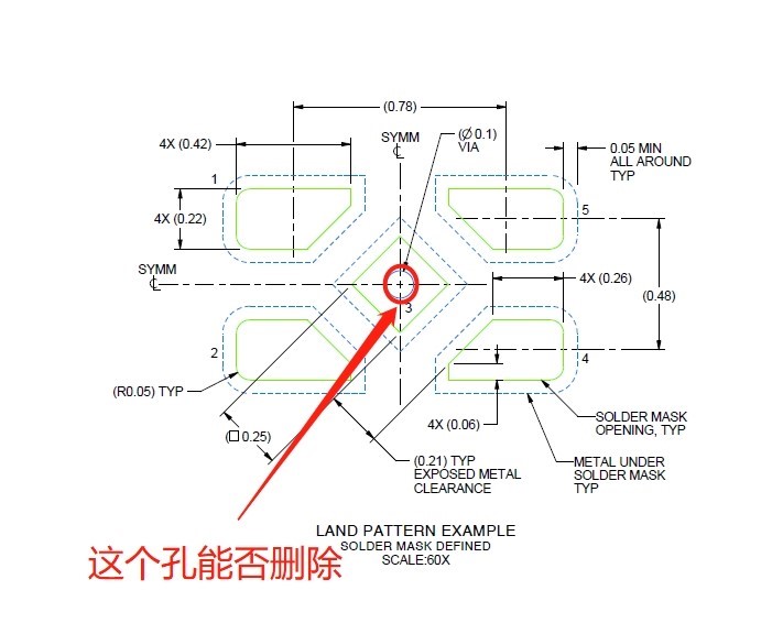

In the PCB layout of the SN74LVC1G08 in the X2SON package, can the center ground pad not use the via hole design?
Hey Lumina,
I believe you are asking if you need to put the via in the middle pad and the answer to that is No.
The gap between the other pads is 0.15 mm at all four sides. It might be possible to route through there. (The suggested layout assumes that you want to go directly to the ground plane.)
Hi Dylan,
I am sorry I don't quit understand what you mean. Could you please provide some reference PCB layout of SN74LVC1G08 in X2SON package?
Kind Regards
Hi Lumina,
You already have an example layout, its up to you to decided whether you want to put a via in the middle pad or trying to route to GND in another way.
