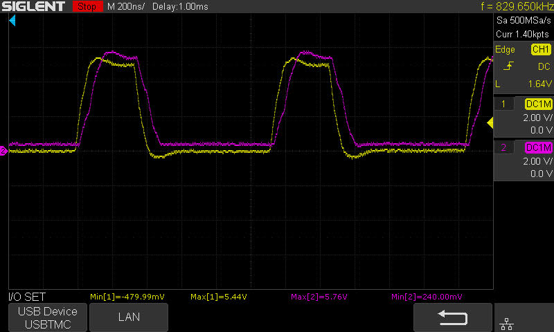

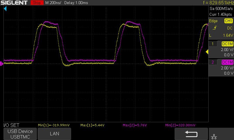

    The device as we call "amplifier" is used for conditioning TTL signal.
    At this figure we can see two channels, yellow for the input signal and purple for the output. This one was created with use of 5m cable before and 5m cable after the amplifier, with 10A current going through the supply lines. You can see GND level change because of that.
    Next figure shows 10m long cable before the amplifier. It makes the GND level even lower.
    Do you think the input signal low level could be reason for the damage? We have tried to do so, but we have never burnt this IC when we wanted to, it was always sporadic.

  • Ok, sorry. Here are pictures again:

  • Hey Tom,
    If the input signal gets to be more than 0.5V below ground, then it will activate the negative input clamp diode on the device and could end up drawing a lot of current / causing damage. Adding some extra series resistance at the input would prevent this from happening (at least preventing damage).  The limit is 20mA for the device, so 1kohms should work well to prevent issues. For normal operation, that won't cause any side effects since the input is very high impedance already.
    The two big problems I see are that your input transition rate is slow, and your output is overloaded.
    The input signal transitions in about 100ns. At 5V supply, the LVC1G08 needs an input that switches in about 25ns (check recommended operating conditions table for the exact spec).
    Since you're not using the device as an AND gate, but as a buffer, you could switch to the SN74LVC1G17 to avoid the first issue. It has Schmitt-trigger inputs, so slow signals aren't a problem  You'd still need to limit the output current some though, as that is certainly overstressing the device.
    There's an FAQ on why slow input signals are bad for CMOS logic here: [FAQ] How does a slow or floating input affect a CMOS device?
