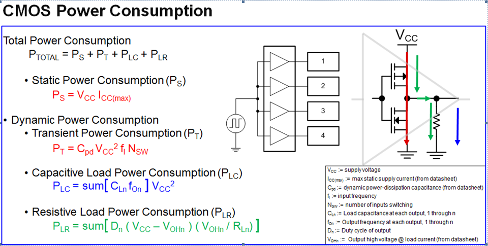

We would like to know the power consumption estimation.
Input voltage is 1.8V. Output voltage is 1.2V. Input signal is 25MHz clock.
We would like to know the power consumption current. I think load capacitor information is needed.
Would you let us know how to calculate the power consumption current of each supply?

  • Hello Toshihiro,
    You can use the following slide to help you calculate your power consumption.
    For more information we have an appnote that helps in calculating power consumption of a CMOS device.
    I will also link you to this previous E2E post that helps a customer calculate their power consumption as an example for you to use.
