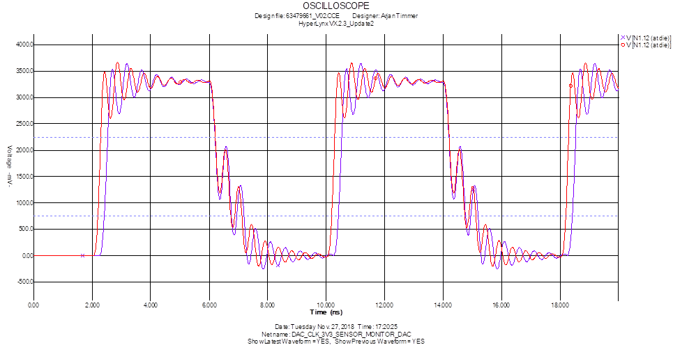

We want to use TI SN74AVC16T245DGVR to translate DAC CLK and DATA[13:0] from 1.8V (FPGA I/O) to 3.3V (DAC I/O).
DAC_CLK = 125MHz (tCLK = 8ns).
Schematics:
Layout:
3V3 DAC CLK and DATA[13:0] traces are all on PCB bottom, and routed with 50 Ohm impedance.
Trace lengths are matched and only ~7.0mm long.
SI-analysis was performed on all signals using HyperLynx.
TI SN74AVC16T245DGVR IBIS file is downloaded from http://www.ti.com/lit/mo/scem451/scem451.ibs
Analog Devices AD9707 IBIS file is downloaded from https://www.analog.com/media/en/simulation-models/ibis-models/ad9707.ibs
1.8V signals are fine.
3.3V signals from level-shifter to DAC all look very bad:
The 100 Ohm series resistor that is mentioned as a possible solution is not an option, since there is not enough space on this fully populated PCB.
Besides, risetime and fall time of the signals are very asymmetrical. This makes it more difficult to get proper setup and hold times at the DAC device.
As an alternative a compatible level-shifter from NXP/Nexperia was used in the SI-analysis (74AVC16T245DGV).
https://assets.nexperia.com/documents/ibis-model/avc16t245.ibs
Those results looked very fine, with no excessive ringing and symmetrical edges.
from TI IBIS file: t_fall = ~3*t_rise
[Ramp]
| AVC16T245_IO_33
| variable           typ               min               max
dV/dt_r        1.97/2.35E-10     1.79/3.59E-10     2.16/1.73E-10
dV/dt_f         1.95/7.46E-10     1.78/1.00E-09     2.14/3.31E-10
from NXP IBIS file: t_fall = ~t_rise
[Ramp]
| AVC16T245_BION_33
dV/dt_r 1.8726E+00/4.0904E-10 1.6970E+00/5.1595E-10 2.0455E+00/3.8291E-10
dV/dt_f 1.8731E+00/4.1216E-10 1.6981E+00/4.1634E-10 2.0457E+00/4.2922E-10
 Can you explain what goes wrong with the TI part?
Paul

  • Hi Dylan,
    My SI engineer did a quick check. Unfortunately, the results of the 8ch-part (see below in red) look very similar to the 16-ch part (blue).
    If this is the real behavior of the part (both the ringing and very asymmetrical edges), then I'm afraid we can't use it and have to go to the NXP alternative.
    Can you somehow quickly bench-test this?
    Paul

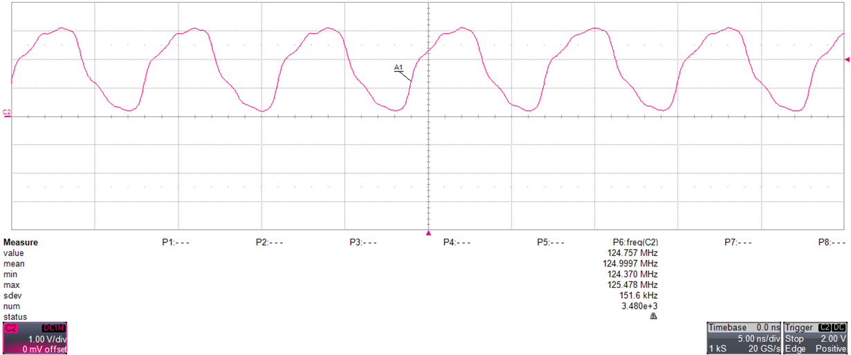

  • Hi Paul,
    I'd be glad to test this on the bench and get you data tomorrow. As for the difference for the rise/fall variation, this is due to the slight difference in drive strength of the high side and low side driver. I'm also in process of obtaining a different simulation software to rule out any issues with the hyperlynx software just as a sanity check.
  • Hi Paul,
    The error is with the IBIS model itself so I will put a request in to put this on the queue for the modeling team to fix.
    As for my bench test the data is shown below. I matched your setup, with one caveat: my cables connecting my board to the oscope loaded the device with roughly 70 pF which you can see makes the edges rounded. Obviously, in your case I'd expect to see half that capacitance on the load so your waveform will be much more square.
  • Hi Dylan,
    Thanks for doing the bench test.
    Indeed, there is no visible ringing. I'm still not 100% convinced that this is real component behavior, or that it is due to the capacitive load that is much larger than in our situation.
    The expected asymmetrical edges are not really visible, maybe also due to the capacitive load? Or is the IBIS model also incorrect in that aspect?
    Is it possible for you to repeat the bench test with an active probe, so that capacitive load is minimized?
    Paul

  • Hi Paul,
    Here are the new waveforms:
    I zoomed in and added a rise and fall time measurement so you can see how balanced the output driver is:
  • Hi Dylan,
    Thanks for re-doing the test.
    These signals look good. No hint of ringing, and the edges are nice and symmetrical.
    My conclusion is that the original IBIS-file was not OK on both these aspects. Do you know if and when an update of the IBIS-file can be expected? We would like to have this update for future use in other projects.
