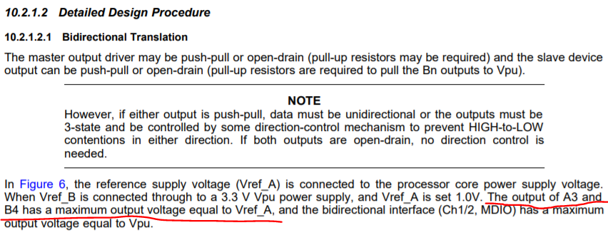

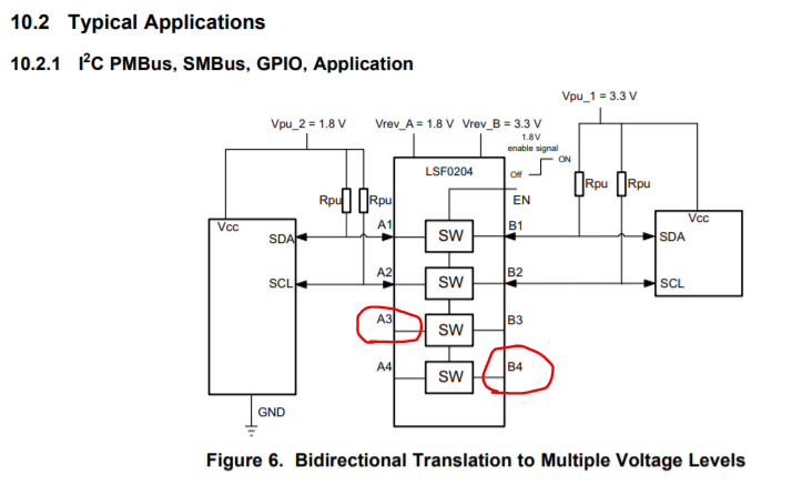

Hi Experts,
We are confusing about below statement for LSF0204 datasheet regarding to below typical application - why A3 and B4 will be limited by Vref_A voltage? Per our understanding, Bx side should be referred to Vref_B, is it right?
Thanks.

Thanks for reporting this issue. You are correct, this looks to be an error in the datasheet. I believe the intention was to say that A3 and A4 instead of A3 and B4.
I will mark this to be fixed in the datasheet however it will be some time before that is done.
Here is a translation guide on the LSF device you can refer to, to understand its operation: http://www.ti.com/lit/an/slva675b/slva675b.pdf
