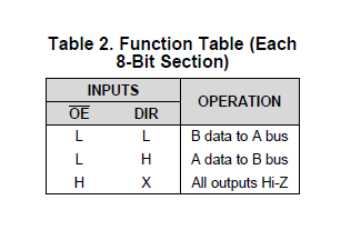

My customer will use only 5ch although SN74AVC8T245 has total 8ch.
I would like to make sure the unused I/O pin connection will be better.
The floating will be OK?

The device has CMOS inputs. Floating CMOS inputs is not okay. You need to either tie the inputs to VCC or GND. Here is a FAQ that talks about this:
https://e2e.ti.com/support/logic/f/151/t/737694?tisearch=e2e-quicksearch&keymatch=FAQ%20slow
You can leave the outputs floating.
