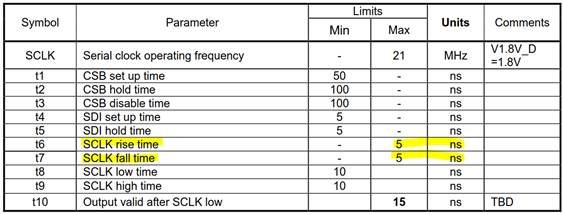

It is not allowed by next stage IC. The spec is only 5ns

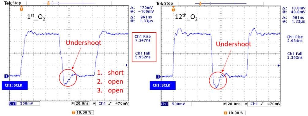

Second one: 1. series resistor=short, 2. open drain resistor=open, 3. parallel capacitor=open
Result:   rising time has improved but it will have undershoot behavior
May I have your help? How to improve the undershoot behavior ? Is it the measurement error or not? The input capacitance of probe is about 8pF. The trace between level shift  to SDI IC is about 8000mil.

    The undershoot might or might not be a measurement error. Anyway, to reduce ringing, you should have a series resistor that (together with the buffer's output impedance) matches the trace's characteristic impedance. Alternatively, consider the SN74AUC1G17, which has output drivers that reduce line-reflection noise (see section 2.1 of Application of the Texas Instruments AUC Sub-1-V Little Logic Devices).
  • Hi Feng,
    As Clemens stated, it may or not be an error. However, based on the customer trying to increase transition speed, it doesn't surprise me that the undershoot would get worse.
    Clemens is spot on with the suggestions that should help you with this. Here is also an FAQ that covers this:

    The next stage of level shift is a SDI IC and it ask the rising time spec should be smaller than 5ns.
    From our measurement result , it will be higher than it. It will be 1xns at the worst result.
