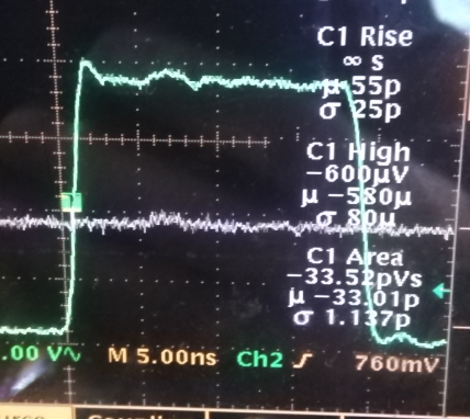

Dear colleagues,
Our customer input a bell shape waveform, then output square waveform.
But after 20 hours of continuous work, output changes to bell shape waveform.
And turn off the power, after a half-hour, turn on again, waveform recovery.
So do you have some suggestions on this issue?
Wrong waveform:
Right waveform:

  • What is the length (time) of the bell shape?
    The SN74LVC125A datasheet mentions the input transition rise or fall rate limit of 8 ns/V; I do not know why the SN74LVC541A datasheet keeps silent about.
  • Hi Rock,
    Following up to Clemens's request, could we get more information on the timing of the input waveform (rise time / fall time / length of the bell shape / length of time between bell shapes)?
    It would also be helpful to know the supply voltage, as that affects the propagation delay between input & output.
    Thanks!
