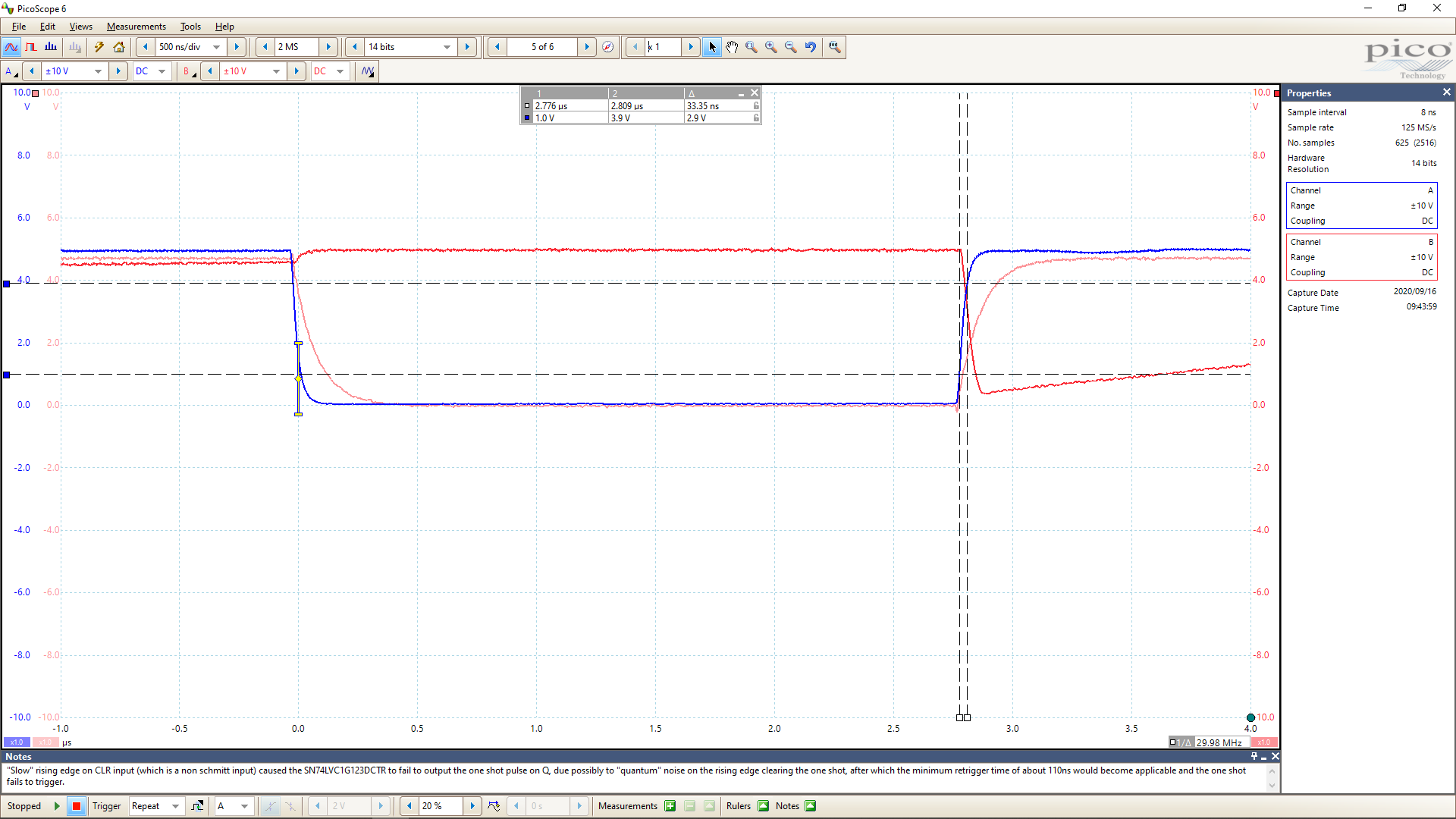

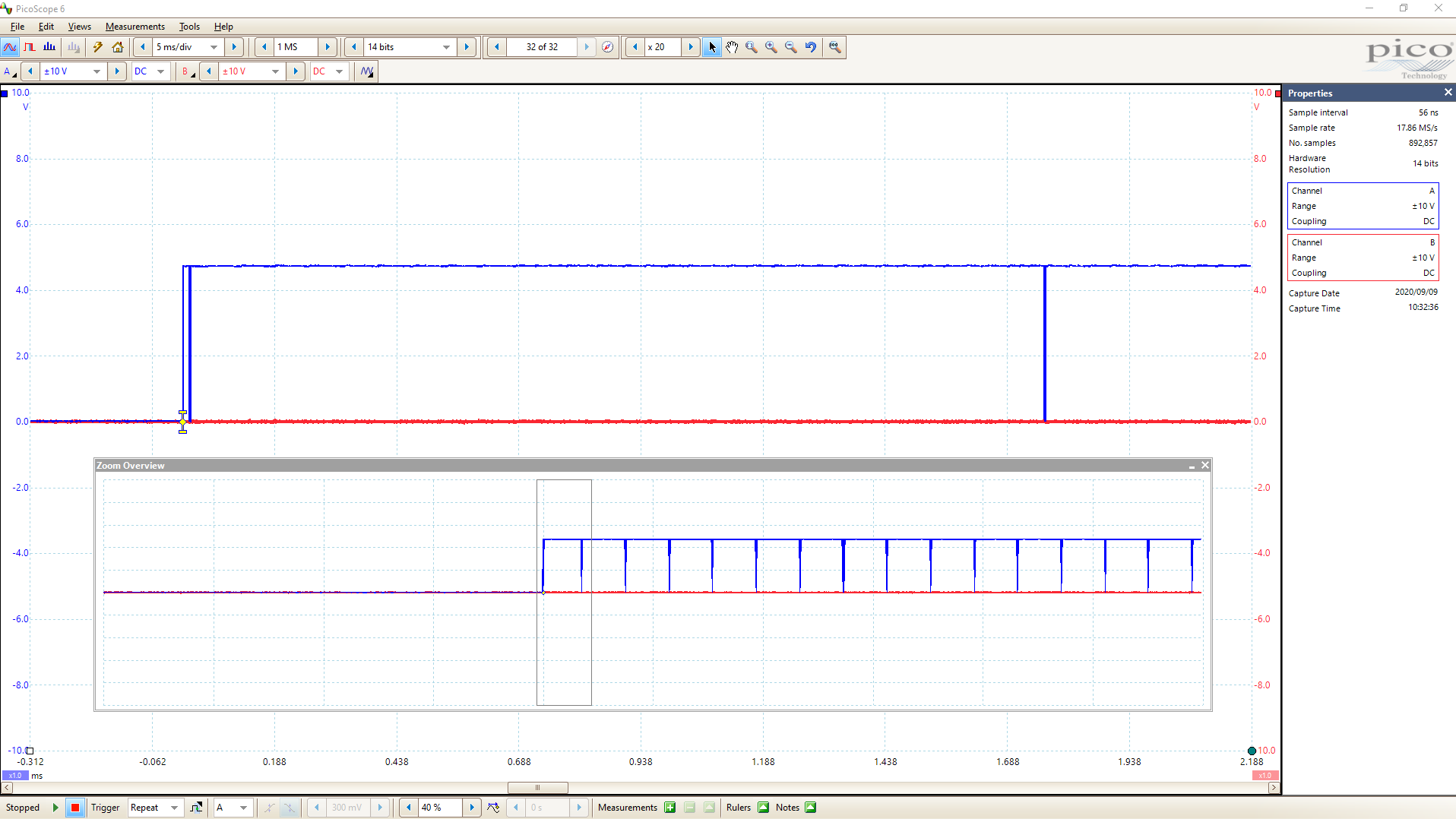

I have included 2x scope screenshots.
Ch-A the blue trace, probe is on the CLR input.
Ch-B the red trace, probe is on the Q output.
The "TI fail to OSC" file shows that the one shot is not raising the Q output to high at room temperature and the "TI osc at temperature" shows the same capture and circuit functioning when heated with a hot air pencil.

    Another unit I tested, became functional once I applied pressure by pressing on top of the package with a screwdriver, which jogged the memory of my experience with a fractured package breaking a bond out wire. (It is however possible that that particular unit was a red herring and in fact may have been a poor solder joint, even though I would say it is unlikely that that was the case, as the joints had been inspected with a magnifying glass.)
    Ch-A (blue trace) is the CLR input after changing R9 to 1k.
    The light red trace is a reference capture of CLR when R9 was still set at 4k7
    Ch-B (Red trace) is the RC pin and can be seen to be functioning correctly with the faster rise time on CLR, where as previously is stayed permanently high and Q remained permanently low.

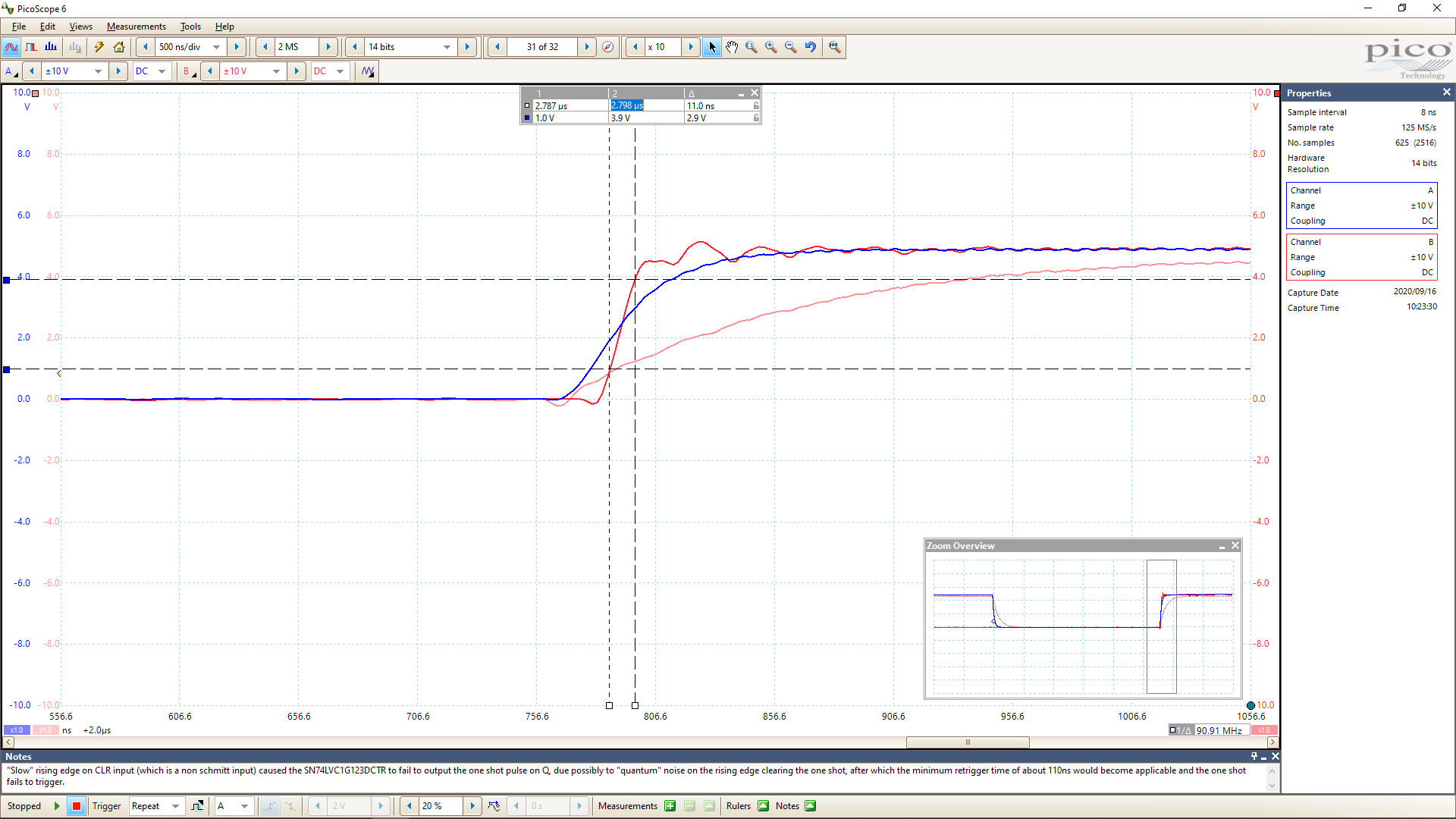

  • One last capture for interest.
    I decided to look at the Q rise time of the SN74LVC1G123 and measured it at 11ns.
    Bear in mind that I do have the Q output loaded with a 180 ohm into the gate of a FET capable of Id of 5Amp
    The red trace is the Q output pin, the blue trace is the CLR input after R9=1k and the light red reference waveform is the CLR input after R9=4k7
