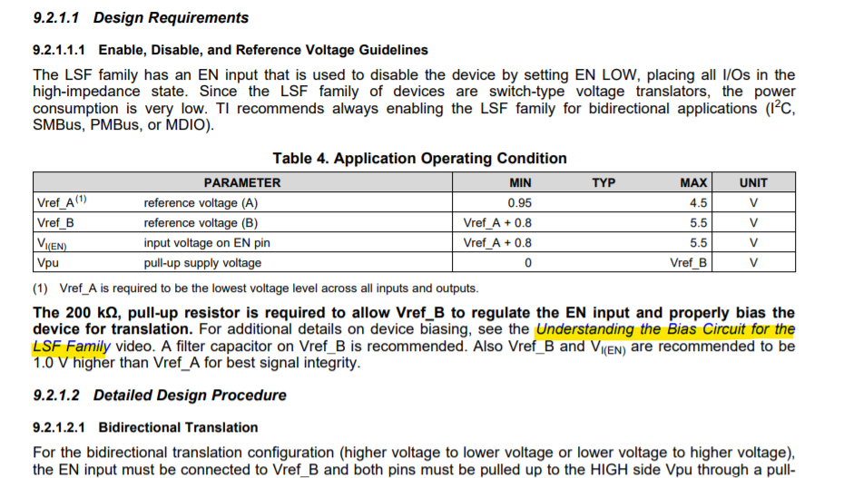

Hello experts,
I have question about pull-up resistor connected with Vref_B.
Typically, 200k ohm resistor is used, but 220k ohm resistor is acceptable?
From training video "Understanding the Bias Current for the LSF Family", the resistor have impact for current flow into VCCA from VCCB.
So, if we use larger value resistor, current value become smaller, and if it is acceptable on VCCA side, there is no problem.
Is my understanding correct?
By the way, the link(https://www.ti.com/lsf-bias) in datasheet P13 is not working.
Could you check please?
