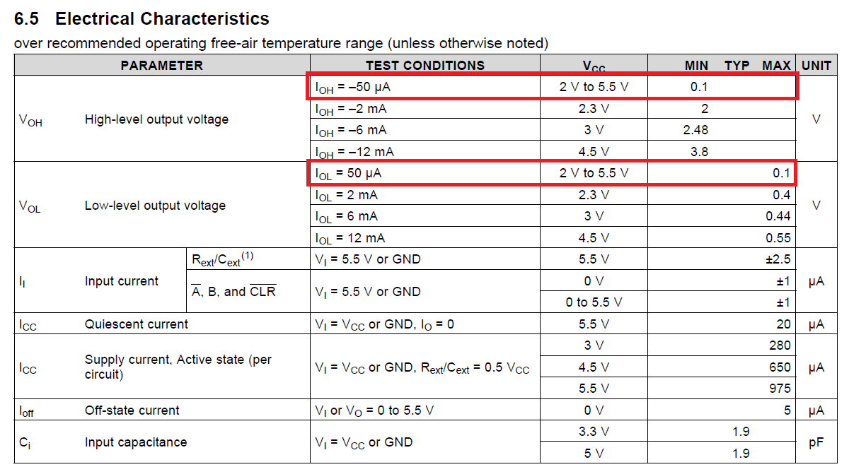

I have qustion about the SN74LV123AQPWRQ1.
Does this mean that when IOH (1Q, 2Q and its inverted output) is small, VOH is only guaranteed above 0.1V?
Also, I am thinking of VCC = 5V. In that case, what will happen to the output?

Hi Ladisch,
Thank you for quick reply. please modify the datasheet.
Uchihara
Hello Uchihara-san,
Just FYI, Clemens doesn't work for TI, although he is extremely knowledgeable on our parts and helps us a great deal on the forums.
I have added this error to our errata list to fix. Due to our current works in progress, I would expect this to take at least several months to get updated. Please let me know if you have some requirement that would increase the priority. You can contact me by email if necessary to provide details.
