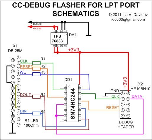

Dear Sirs,
Any ideas what went wrong with my CC Debugger: I was working with CC1110-DK Mini board attached. At some point IAR said about the problem with driver and then hanged. I've looked at debugger's led - it became yellow (orange): both green & red leds were on. Now I can't see the debugger neither from HW Manager on my PC (I've tried 2 PCs) nor in software like RF Studio & IAR. I think this may be firmware failure but attempt of starting bootloader by shortening P1.6 to GND failed - it still lights amber. Pressing RESET button cause the led is OFF while the button is pressed.
Any ideas how to de-brick it?

  • I've successfully restored my CC-DEBUGGER without buying second one :) Because buying of the new one for flashing the old one - it's something like PKUNZIP.ZIP :)
    Simple schematics using only two relatively cheap IC's, LPT port, USB for power supply - and now my CC-DEBUGGER is alive. If you want to follow my steps, please take a look at attached schematics, also you'll need usb bootloader firmware for CC-Debugger , which is available in RF Studio, in binary (not HEX) format (attached here:   4130.usbboot.zip ) and software flasher for LPT port I'll publish ASAP here which will allow you to flash your CC-DEBUGGER

    Software can be found here.

    Let me introduce the first version of my CC-Rescue software for the LPT-programmer, described above. This software will help you if you have bricked CC-Debugger with ORANGE LED, which can't be restored via USB bootloader (as described in swru197 document).
    Prior to use this software please note that:
    a) It's tested only on Windows XP. Both Windows 7 & Vista are not supported.
    b) Only hardware LPT ports in Standard or EPP mode are supported. This software will never work with USB-to-LPT adapters, sorry.
    c) Use this software only as a LAST HOPE solution to resurrect your CC-Debugger.
    d) You may use this product AS IS, with no warranties at all. Also Borland Delphi 7 sources are included - so you may freely upgrade it (please refer to me in your builds) .
    HOW TO:
    1) Make my LPT programmer as described in this topic, download RAR archive, attached to this post, unrar it to any folder.
    2) Connect programmer to your damaged CC-Debugger via internal debug port of CC-Debugger. Prior to this step please check that your CC-Debugger's hardware (incl. LDO 3V3 source) is OK. Also check that your CC-Debugger is not connected to USB port, the only one connection should be made between PC and CC-Debugger: using LPT port & my device. CC-Debugger will get power from my device.
    3) Connect programmer to LPT port and than to USB (to switch power on).
    4)  Start CCRescue.exe
    5)  Now, first of all, check LPT's base address. It's set to 0x378 by default.
    6) Press "1.  GET CHIP ID"
    7) Take a look at log window. There should be a message that CC-Debugger is found. If not - re-check everything.
    8) Now try to make a backup copy of CC2511 flash - press "2. BACKUP CC-Debugger", please wait (about a minute, it looks like it hangs, but it's OK). Now specify filename to save backup image to.
    9) Now you are ready to try to rescue CC-Debugger. Press "..." button near the filename field. In the dialog please select new firmware binary image. You may flash SRF05DBG.BIN (from "firmware" folder of archive) - it's a usb bootloader, that will allow you to make your CC-Debuger flashing RED LED, and than restore it as described in swru197. The alternative way is to use "full-backup.bin" - it's a full backup of working CC-Debugger (not only USB bootloader).
    NOW YOU ARE READY TO PRESS "3.  FLASH CC-Debugger" BUTTON! JUST DO IT!
    Wait until flash process is finished. Now detach your CC-Debugger from programmer and try to connect it to PC via USB. It should work. (LED should be RED or BLINKING RED, depending on firmware you're selected).
    GOOD LUCK!
