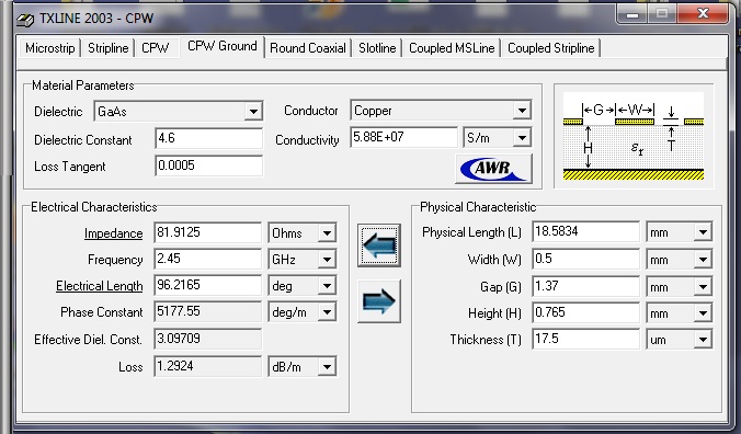

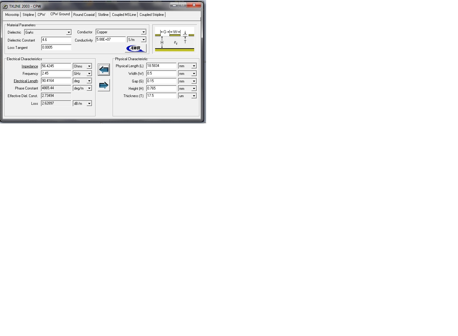

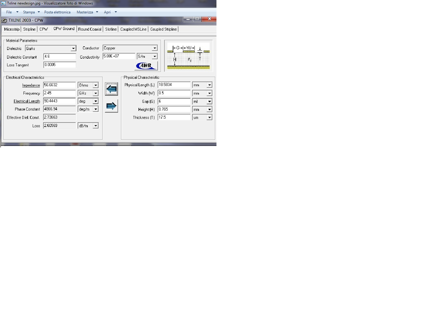

  • Hi
     I have The same problem,  with my  electronic revision  cc2500,
    This electronis system isn't able transfert all packets of the equal distance but the range the transmission is variable with from 3 to7mt.
    Old device:I have calcolate a impedance between balun and antenna by Software Txline and it's 81.91 ohm (in attached the picture-Txline old design.jpg)
    I have 3 question for "redesign the trace antenna-balun"
    1)Recalculate and place a new trace between antenna and balun with impedance of 50 ohm, I had calcolate by Txline a impedance of 56 ohm and considering of application a solder mask over antenna  for decrease of 3 ohm(in attached the picture-Txline new design.jpg)
    2)Recalculate and place a new trace between antenna and balun as described to the point 1 and place a resistor 0 ohm between antenna and trace balun?
    3)The resistor value is 0 Ohm?
    Thank you
    Best Regards
    2627.redesign antenna-balun.rar
  • If you do the calculations a impedance equal to 80 ohm vs 50 ohm does not cause a significant signal loss. Have you checked if it's other details with your design that could explain low range?
