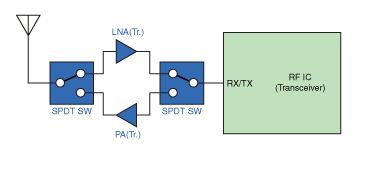

  • last one: can you recommend an according SPDT and design recommendation (never used these parts before)?
    Recommend SKYWORKS (SKY13323-378 or AS179-92LF) for a SPDT.
    Regards, Richard.

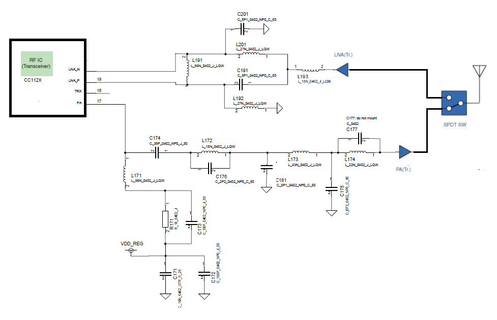

    I don't want to bother with Semtech & Co., so taking your suggestion with external PA, how do I integrate this in a CC112x design (tranceiver mode) in reality:
    a. do I need to disconnect discrete PA input AND output via 2 x SPDT plus shutdown power for that PA whenever I want to RX with 112x?
    Means putting this whole block out whenever it's not needed...
    Example block:
    Renesas recommends NE85630 NPN as LNA, but does not give any example integration; could I just skip it and connect in RX direct both SPDT?
    b. Maybe easy for you to provide some more detail about your comment "then the input matching of this transistor can be reduced since the matching in the app note is quite wideband"
    c. Did you measure what spurious/harmonics this design create?
    Thanks again
    Only one SPDT is required, connect a PA and LNA in the following manner with CC112x:
    The matching of the discrete PA is designed for a wideband and since you will be operating a one frequency this can be replaced with a single LC element instead of two stages of LCs.
    We passed all ETSI requirements with the discrete PA design.
        Richard.
