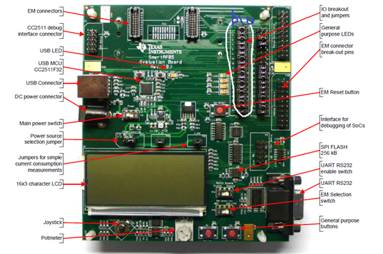

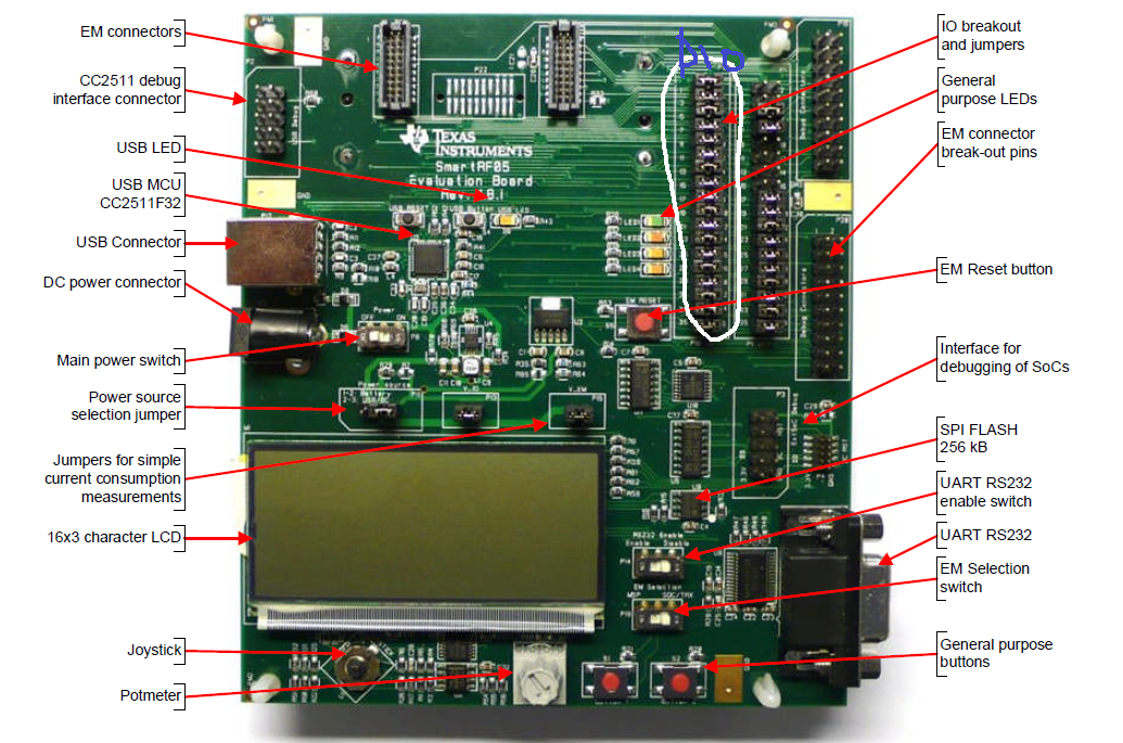

       With that been said, I have tried to look at the datasheet, but it seems very foreign to me. I can tell  you what I want to do. On my SmartRF05 board, there is p10, show in the picture.
    I want to connect some of the pins from p10 to some relays, and programmatically to turn on the relay on and off. As you have mentioned, there is only P0, P1, P2. Where are they on the board? Can you point them to me? I am very confused here. Thanks very much.
    Looking at the SmartRF05EB schematics (swru210) will probably be a very good exercise for you. If you are new to embedded programming, you might as well start understanding schematics right away :)
    In the user's guide, of the SmartRF05EB, you'll find the schematics for the SmartRF05EB in the Appendix section. Now, if you are connecting e.g. a CC2540EM to the SmartRF05EB EM connectors, you'll need schematics for the CC2540EM as well (located in the reference design zip file).
    Now, trace the signal going from header P10 on SmartRF05EB to the EM connector and then from the EM connector on the CC2540EM to the CC2540 chip.
    For example:
    1. 05EB schematics, Top level page: Signal going from header P10, pin 1 to the EM connectors is called EM_JOY_MOVE.
    2. 05EB schematis, EM interface page: EM_JOY_MOVE is connected to EM connector P6.19 (the "right side" connector).
    3. CC2540EM schematics: The corresponding pin on the "right side" connector (P2.19) is connected to CC2540 P2.0
    So, header P10.1 on SmartRF05EB is connected to P2.0 of CC2540 on the CC2540EM.
    To configure CC2540 P2.0 as GPIO output, logic 1:
    P2SEL &= ~0x01; // Setting bit 0 of P2SEL to 0 (setting P2.0 as GPIO pin)
    P2DIR |= 0x01; // Setting bit 0 of P2DIR to 1 ( setting P2.0 as output)
    P2 |= 0x01; // Setting bit 0 of P2 to 1 (since P2.0 is gpio output, this will set the pin to logic 1)
    More information about the CC2540 GPIO pins can be found in section 7 of the CC2540 user's guide (swru191).
    Hope this helps!
    Br,
    ABO
    PS. Thank you for clicking  Verify Answer  below if this answered your question!
