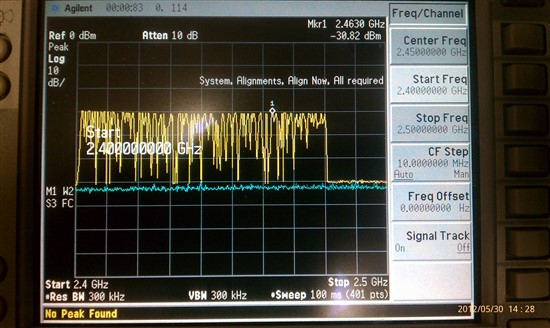

  • Hi Arild,
    I ran the command VS_Set_Frequency_Mode (0xFF06) with parameters 00,00 and then checked the frequency range usage again. It still seems to be using the US range (2400-2483.5).
    I'm not sure if we are missing anything here. Can you comment on this?
    Also, it's my understanding that even though it may meet the PSD requirements, we still need to use the reduced hopping frequency range in order to inter-operate with BT devices in Japan.
    I'll attach a picture of the Spectrum Analyzer plot that shows the usage of the US range.
    Mike
  • Hi Mike,
         As discussed in the thread above, there is no need to reduce the number of hopping frequencies for Japan to comply with regulatory purposes. Regarding interoperability, the AFH map is provided during connection so it should not be a problem. Could you provide more information on why you think it is needed?
