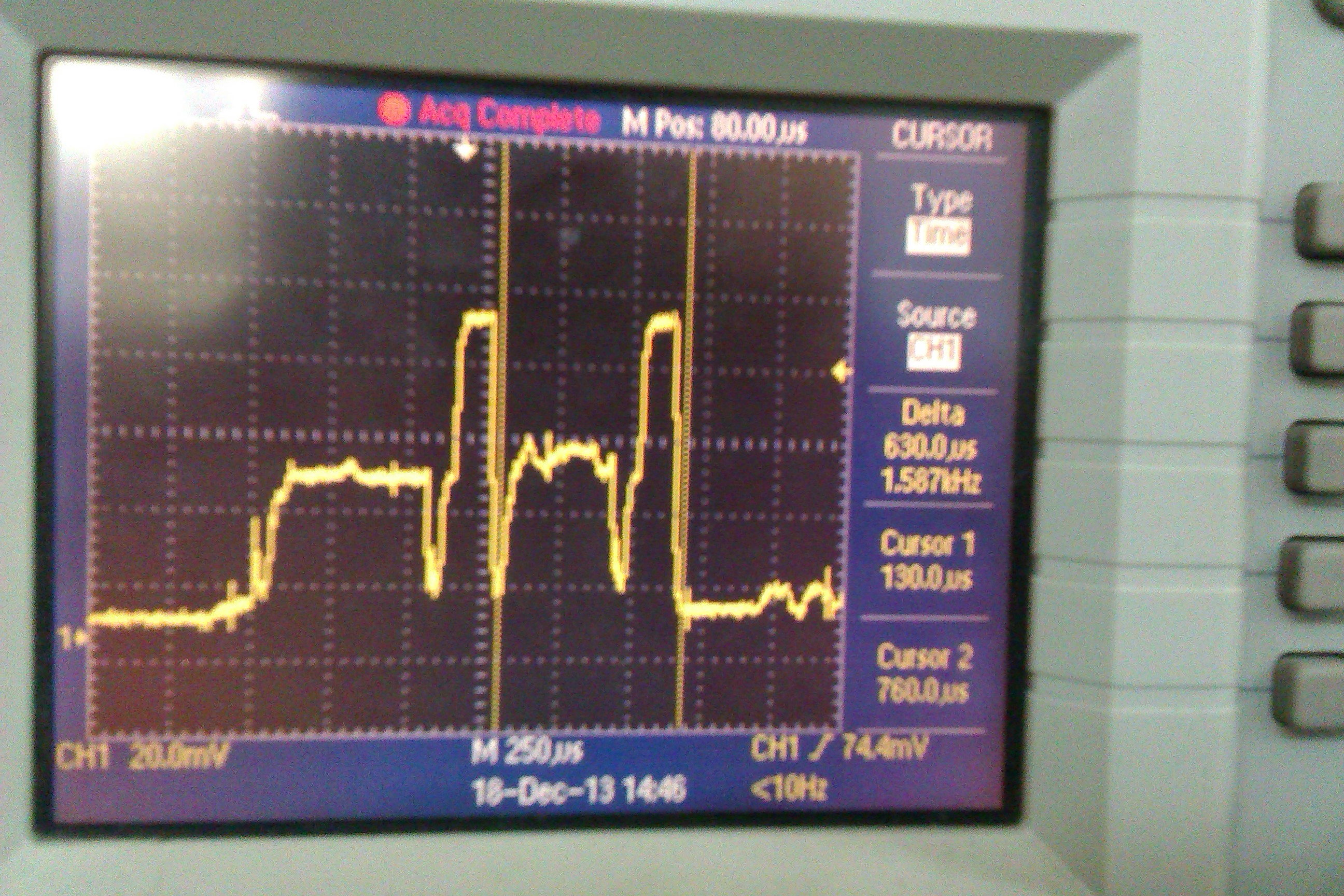

  • Hi Sundeep,
    I'm measuring the rf256x evulation board.
    Server->SPPLEDemo, advertise on
    Client->SPPLEDemo, connectedLE to Server.
    Measurement server board.
    When connected and advertising:
    this happens every 200ms.
    When sending 10B:
    Only one occurrence.
    Period=600us
    Bits=8*10=80
    TP=(80/1000)/(0.0006s)=133.33kbps ??
    David.
  • Hi David,
    It will be accurate if you take the time from the sniffer log.
    Usually the throughput test is conducted in a shield room, as it will depend on the environment where you are testing it.
