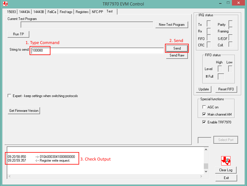

  • Like Jonathan I'm facing now the same problem.
    Shouldn't it be possible to write the Registers directly by the GUI with the Test-Tab?
    Example: I want to write 0x80 to the Register 0x00, so I do the following:
    Unfortunately, this does not work for the UID (write continuous) command. Am I doing something wrong?
    First I set the UID length to 4 bytes:
    101800
    Then I try to set the UID: (I try to set the UID to 0x80 0x12 0x34 0x56):
    101780123456
    After that command, the EVM is no more responding to the GUI. Is there anything wrong with the command 101780123456? (Maybe the first Byte 0x10 declares a "write" command instead of a "write continuous" command?)
    Even if I don't send this command, my Nexus 5 smartphone doesn't recognize the AEVM as a NFC Tag.
    Could you detect any mistake in my approach?
  • Hi Remo,
    As Josh mentioned, the TRF7970AEVM isn't meant to do Card Emulation mode. The firmware modifications Josh spoke of would be to the source code. Additionally you'd need to handle replying to the Android phone commands quickly enough to not timeout, so I have doubts that sending custom strings through the test tab manually would activate a phone like the Nexus 5, which means you'd have to add additional source code to handle the activation sequence.
    I would recommend that rather than use the EVM for something it is not really setup for, you look at our Card Emulation software example on our LaunchPad+Boosterpack combo. This firmware is for our NFCLink Standalone software stack and supports Card Emulation for Type A and Type B. We have done a lot of interoperability testing with this to support the latest NFC handsets as well. It will be quicker and provide far better performance than attempting to modify the EVM firmware.
