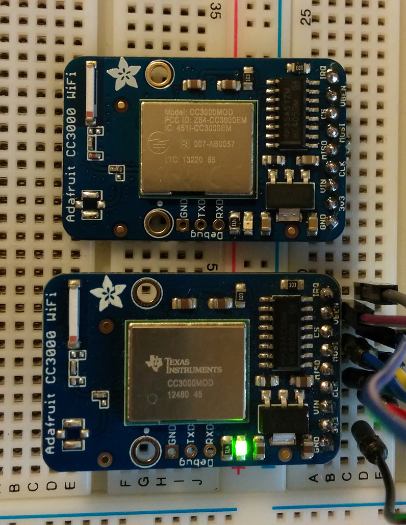

I'm using the Adafruit CC3000 module with the TI MSP430 Launchpad with an installed MSP430G2553 and I am having trouble with some of the WiFi modules. I ordered 4 Adafruit Wifi Moldues and received what appears to be 2 hardware variants of the CC3000 chipset. One of the variants works perfectly, while the other hangs in the initialization of the driver in the hci_event_handler at:
if (tSLInformation.usEventOrDataReceived != 0)
I've kept everything the same and simply swap CC3000 modules and have confirmed the error only occurs on one variant. I have updated the driver and firmware packages on all modules. I have attached an image showing the two variants. The top chip (13220 85) is the one that hangs, while the bottom chip (12480 45) is the one that works fine.
I posted a similar question on the Adafruit forum but the problem seems to be in the variants of the TI CC3000 chipsets. Are there any differences between these two chipsets?
