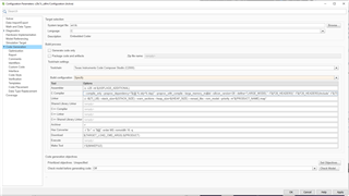

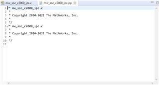

    I'm trying to optimize the code which uses the function memcpy. I read a TI document for Optimization spru514w, which says that -mt instruction will take care of optimizing the memcpy using RPT PREAD instructions as shown below.
    But, when I run the code I cannot see any such instructions & also saw that the memcpy taking too much time, certainly felt that the memcpy need to be optimized using this option.
    Also, I'm using the model based design (simulink) to build and felt somewhere it's missing the option of -mt.
    Need some assistance in this regard,
    Raju.
  • Hi Mathew,
    My final intention is to optimize the memcpy. Kindly suggest suitable solution for the same.

  • I'd like to understand why the call to memcpy does not get inlined.  For the source file with the problem call to memcpy, please follow the directions in the article How to Submit a Compiler Test Case.
    Thanks and regards,
    -George

    1.Compiler Version: got it from map file
    TMS320C2000 Linker PC v18.12.2
    OR
    ti-cgt-c2000_18.12.2.LTS
    2. Build Info

  • Unfortunately, the preprocessed file only contains comments.  I'm not sure what went wrong.  Please try again.  This post on attaching a file may be helpful.
    Thanks and regards,
    -George
  • Hi Geoge,
    I'm able to see only those 10 lines which are showing in the above picture.
    Don't know why?
    7183.mw_soc_c2000_ipc.txt

    Changing topics ... I took a close look at your compiler options.  You compile without optimization.  For any function like memcpy to be inlined, you have to use at least --opt_level=2.  Please build with --opt_level=2 or higher.  Please let me know if that change resolves the problem.

    In fact as I told, I'm using Matlab simulink for this process and added -mt flag at assembler section of Matlab settings.
    Can you confirm from the build data that the Compiler using this Unified memory (-mt) for optimizating memcpy.
    Raju

  • Raju,
    You mentioned added the -mt option in the assembler section shown below, have you also added the "--unified_memory" in the C Compiler Section?
    Matthew
