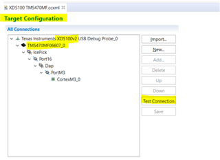

      I think VCC, VSS and OSCIN should be all you need to connect the XDS100 debug probe to the target. In CCS, I suppose you already have a target configuration file for your target device using XDS100. If not, please create one. You can click the "Test Connection" for scan-chain testing. If it passes, then you are good to go. You should be able to connect to the target with no problem.

    Thank you for your response. That is very reassuring and may point to a potential hardware issue. I have created the target configuration file and have been trying to debug the error '-233':

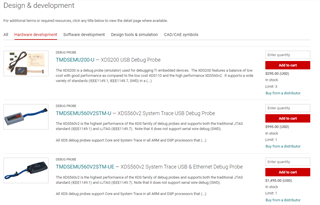

    I also look at the development tools for TMS470MF06607 and I don't see XDS100. Below are the debug probes listed in the product page.  What debug probe does your customer use? I will suggest you try XDS200.
    https://www.ti.com/product/TMS470MF06607#hardware-development
