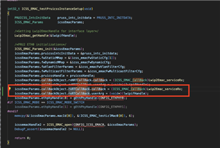

    The team was able to root-cause this issue.
    1. it looks like all the packets are being passed into the high priority queue from the firmware. This is happening only for the MAC1/MAC1 of Dual-EMAC. Due to this, Rx RT callback is supposed to be invoked.
    2. Since we do not have any function assigned as the RT callback in the "icss_emac_lwip" examples, none of the frames are being sent to LwIP. This results in no response being returned from the LwIP stack.
    Workaround:
    1. Assign the LwIP service Rx function as the RT callback. This ensures that the packets are passed to the LwIP stack and the communication with the DUT works.
  • Hi Nilabh,
    Thank you for the workaround. On the evaluation board, I was able to successfully ping the device while operating in MAC1 mode using the provided code. The setIOExpMuxSelection() function worked as expected in that setup.
    However, when I loaded the same code onto our custom board, I was not able to ping the device. Since our custom board does not include a MUX for selecting the MDIO and MDC lines, I have already removed the setIOExpMuxSelection() function from the code.
    Despite that change, the ping is still not working on our custom board. I would appreciate your help in identifying any additional steps or configuration changes that might be required to get Ethernet communication working correctly.

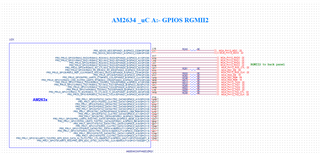

  • Hi Nilabh
    We are integrating Ethernet functionality on a custom AM263x-based board using the icss_emac_lwip example from MCU+ SDK 10.00.00.35. While the software runs correctly on the TI EVM, we're encountering a persistent issue on our custom hardware — the Ethernet link does not come up.
    Unlike the TI evaluation board, our design does not include a MUX for MDIO line selection. Instead, the MDIO signals are routed directly from the AM263x to the Ethernet PHY. To reflect this hardware difference, we removed the MDIO MUX selection logic from the reference example code (icss_emac_lwip_am263x-cc_r5fss0-0_freertos_ti-arm-clang) while retaining all other configurations.
    Additionally, in our design, PRU1 is not used for Ethernet communication — it is repurposed for GPIO functionality to control other peripherals. As a result, only PRU0 is active for Ethernet (MAC1 mode), and the second ICSSG MAC port is intentionally disabled.
    To support analysis and reduce ambiguity, we’ve included the following resources:
    • The updated example.syscfg file reflecting our peripheral configuration.
    • The Ethernet PHY schematic from our custom board, highlighting the RGMII and MDIO signal routing.
    We would appreciate your insight on the following points:
    1. Could simply removing the MDIO MUX control logic — without other adjustments — be insufficient to enable MDIO communication on custom hardware?
    2. Are there any specific registers or initialization steps in the driver stack that implicitly assume the presence of the MUX and therefore require modification?
    3. Based on the schematic, do the MDIO lines (MDIO/MDC) require explicit pinmux configuration (mode, pull-up, etc.) to function reliably without the MUX?
    4. Are there any recommended debug techniques to verify MDIO or PHY activity (e.g., reading PHY registers directly, enabling MDIO logging, or probing MDC/MDIO lines with an oscilloscope or logic analyzer)?
    Any recommendations or clarifications you can provide based on our configuration and hardware setup would be greatly appreciated.

    For HW schematics review please reach out to your local sales executive and share complete schematics so our HW team can review this properly.
  • We tested following on our end:
    1. ICSS_EMAC MAC firmware is decoupled and can work standalone on PRU0/PRU1 for MAC0/MAC1.
    2. To test this we configured the ICSS EMAC application in MAC0 and MAC1 mode and halted + reset the PRU1 and PRU0 respectively. We did not see any break in the communication.
    3. Issue discovered: One issue that we discovered is the ICSS EMAC application loads the PRU firmware onto both PRU0 and PRU1 irrespective of what mode is selected (Switch/MAC)
      1. This is an application level bug, and I have created a Jira bug to track this : https://jira.itg.ti.com/browse/PINDSW-9314(for reference, you will not be able to view it.)
    In that case the non-MAC PRU firmware will get overwritten by the MAC PRU firmware.
