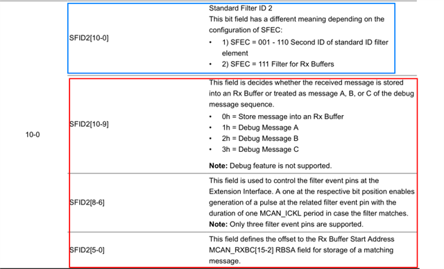

Another question:
SFID2 have  been explain in blue box,   so how to understand the description in red box?

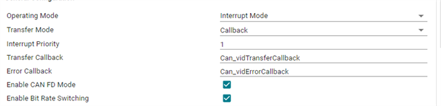

    If your requirement is to receive only 0x2F6 and 0x757 then you have correctly set DUAL filter but your filter IDs are 0x0 and 0x1 respectively in your SysConfig screenshot. I think you should you set them to 0x2F6 and 0x757 (in FIFO mode).

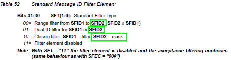

    In order for the filter to capture only the signle ID's the "Classical Filter" option should be used. Where SFID1 = ID to accept and SFID = All 1 (Full Mask to make sure only the exact match of SFID1 is accepted).

    In regards to the SFID2 bitfield descriptions shown in your screenshot, can you confirm the source this screenshot is coming from?
    I am providing an a secondary description of these bits taken directly from the Bosch MCAN User Guide document.
    The details in the red box describe the register bitfield functions only when SFEC = 111.
    When SFEC != 111 or 000, then SFID2 acts as the actual second ID value according to the Filter Type (eg: end of filter range ID value, second filter, ID value or filter mask value)
