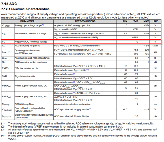

the input signal is +/-100mV, can i connect Vref- to negative voltage for ADC? So, MCU can measure the signal level.

Hi Frank,
Typically VREF- is connected to GND:
I would not suggest applying a negative input as it can forward-bias the ESD diodes,
I would suggest level shifting the signal or using a differential amplifier with the device's OPAs.
