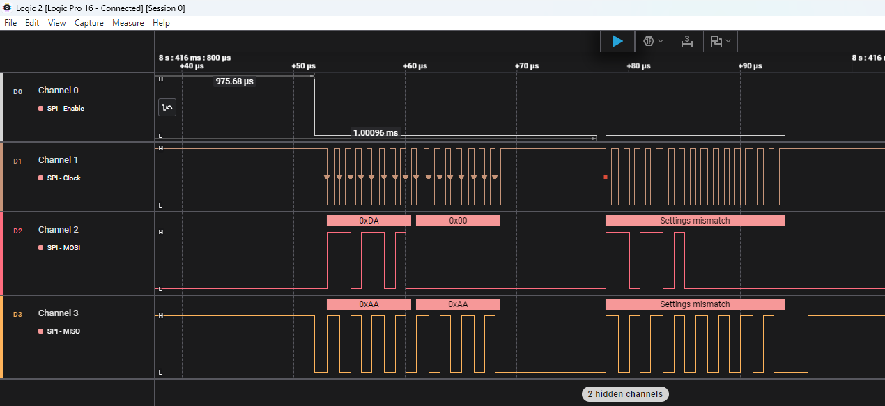

We are trying to communicate between TMS570LS0914 and QCA7006 through SPI_1.
RegistersBareMetal (1).txt
Autosar_SPI_MCAL.txt
  1. With bare metal SW (halcogen generated SPI MCAL), we are able to get the desired resposne 0xAA55 by reading signature register 0x1A00 (Tx command : 0xDA00). As per the QCA7006 datasheet SPI should work in Mode 3 but actually we got the desired output for Mode 2 instead of Mode 3.
2. But as per our application, we have to use AUTOSAR MCAL. So, with AUTOSAR SPI MCAL we are not getting desired response for the same Tx command. Sometime we are getting 0xAAAA or 0x5555 as response.
3. Registers dump of MibSpi1 for BareMetal SW as well as AUTOSAR MCAL integrated SW are attached here.
4. Please provide guidance to proceed further.

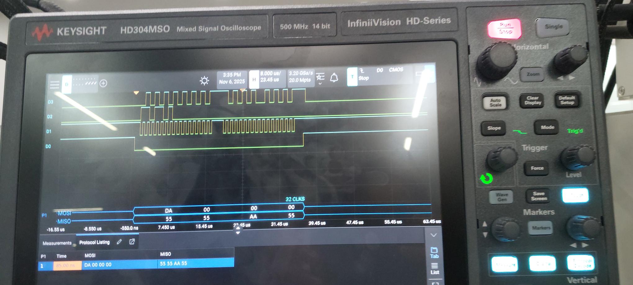

  • Hi Ushan,
    The HalCoGen generated SPI driver works as expected, but MCAL SPI driver doesn't work which interprets 0xAA55 (expected RX data) to 0xAAAA or 0x5555.
    From the attached files, the TMS570 acts as a SPI master when using HalCOGen SPI driver, but it is configured as a slave when using MCAL SPI driver.
    The POL=1, and Phase=0 which mean that the data is output on leading edge (falling) and input data is latched on the trailing edge (rising)  -- Mode 2
    Does another device (QCA7006) use mode 3 (POL=1 and Phase=1)? I think both should use the same mode.
  • Hi Wang,
    Thanks for your response!!
    Now we have configured the SPI driver (TMS570) as Master but still we are not receiving the correct response (0xAA55).
    New register dump of AUTOSAR SPI MCAL has been attached here. Now we have configured SPI for Mode 3 as QCA7006 support SPI Mode 3.
