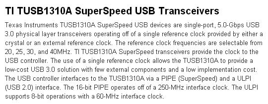

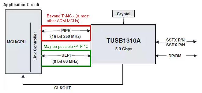

    May it be noted - that (almost) surely - the TM4C (and all similar ARM Cortex M4 AND M7 (200MHz+) - prove  FAR 'over-challenged' - in such (high-speed serial data transport) task!
    BACKGROUND:
    Note too - poster Chester appears to have performed an investigation (highly similar) to that of my firm's 'College & (gifted) High-School Intern staff' - earlier this summer.
    Poster/Friend '12 Squared' (that superior forum id was crafted at 'no charge') was the VERY first poster to introduce '8b/10b' to this 'LM3S/LX4F/TM4C' plain.    After (gentle) interrogation - 12 Squared 'made the case'  for 8b/10b - and an (intern-staffed) investigation was launched.     Our findings were (similar) to poster Chester's - but for the fact that our key clients - and investors - DEMAND 'Vendor Agnostic' - believing such insures (capture) of the, 'Broadest, Highest Performing, and most Up to Date' data.    Follows (below) our interns'   key findings:
    The 'Breadth & Depth' of  '8b/10b' - proved 'shocking.'    (especially its use by 'USB3.0' (in highlight - above)     While we are 'directed' to 'Search w/a broad brush' - we maintain loyalty to (this) vendor - by noting an IC  which appeared a 'Significant Aid'  to,  'Those seeking to exploit '8b/10b.''
    and
    Vendor's 'TUSB1310A' appeared IDEAL to our interns (and (sadly) to myself -  'boss' to these interns).     Alas - it was quickly discovered - that  'Technology' may prove a (very) 'fleeting friend.'
    It is believed that 'TUSB1310A' (from this vendor) was released in mid CY 2017 - and has already - been declared  'NRND!'     (Can you say LM3S?)
    Conclusions:
    I can dream, can't I? I searched for a TM4C solution because we have experience with this platform, we have much code developed for it, and in general I like to stick with a MCU family if possible. (We already have quite a few part numbers from other vendors as well and I can tell you that each additional platform requires much headache and expense to get "up to speed.")
    Now, I have come to the conclusion that a part like TM4C123AH6PM should be able to generate 8b/10b encoding beautifully by encoding the message in a buffer in memory and transmitting it with the help of DMA through the SSI peripheral -- BUT there is one caveat: the least common multiple of 8 and 10 is 40, which means that data can only be sent in 4-byte increments (those 4 bytes turning into 5 bytes when encoded as 8b/10b, hence 40 bits). If I wish to stick with TM4C for this, this would be a limitation of the communication protocol that must be respected. As for receiving 8b/10b encoded messages, reception is "SIMPLY" the reverse of transmission. (NOT so! But then if you've ever repaired your car with the help of one of those manuals they sell at the auto parts stores, and if you are an especially astute reader, you will have noticed that they give dismantling instructions in excruciating detail and then, with the whole guts of your car in pieces, you reach the reassembly instructions which are: "assembly is simply the reverse of disassembly." And let me assure you that that is NOT the case! In one repair -- head gasket replacement -- it took disassembling and reassembling the head FIVE times! Then I started the car and engine oil shot out all over the place like a fountain. What's the problem? The head gasket was on BACKWARDS! It looked symmetric, but there were very "minor" differences. But on the sixth try, it worked.)
    The dreaded NRND.

    Because if its speed, USB3.0 is a tall order for probably most (if not all) MCUs out there. I would have to conclude that such a solution would require a FPGA to generate the required signaling at high enough speeds; yet then the TM4C would communicate with this FPGA at much slower speeds, becoming the bottleneck.
