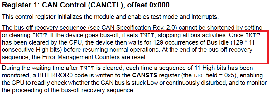

Would you please teach me the reset condition of REC and TEC bit in CANERR register?
Is The REC and the TEC bit in CANERR rest by Rx bit in SRCAN?

Hi Kuerbis,
Yes, the CANERR register will be reset by software reset via SRCAN register of system reset. I also did an experiment that once the device goes bus-off, it sets the INIT bit in the CANCTL register. If the INIT bit is cleared by the CPU the CANERR register is reset again. The datasheet also explains the same.
