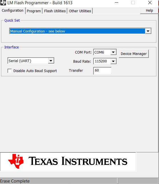

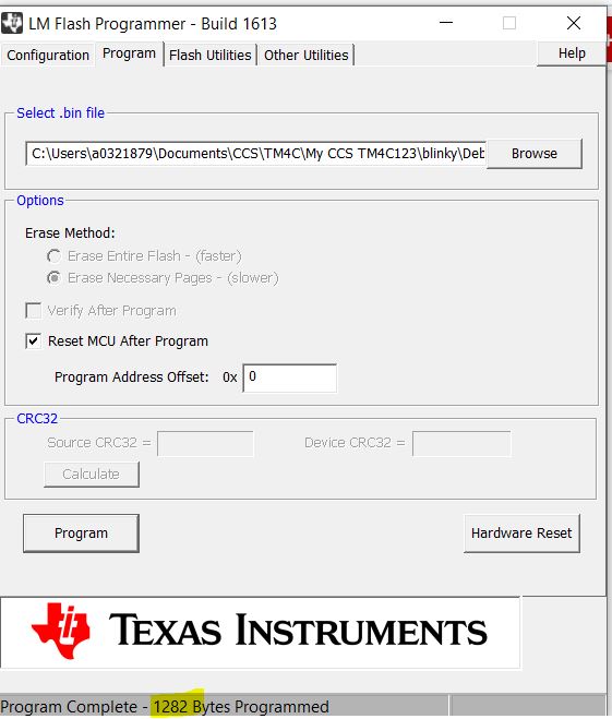

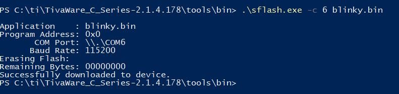

      This is the first time I've come across a reporting like yours. I have a launchPad with version 7 MCU silicon. I just do a ROM bootloading using both the LM flash programmer and the sflash.exe utility. In both cases, there is no issue booting the MCU using the ROM bootloader. I have the auto-baud rate enabled.
    Using sflash.exe
    Using LM flash programmer.
      Can you please answer me some questions?
      - Are you seeing the issue with v7 on only one MCU all the v7 MCUs you have?
      - Can you try either the LM flash programmer or sflash.exe on your v7 MCU? Do you see the problem? I want to know if this is download tool related.
      - Can you try to use your host processor to boot a TM4C123 LaunchPad with version 7 if you have one? I want to know if this is board related.

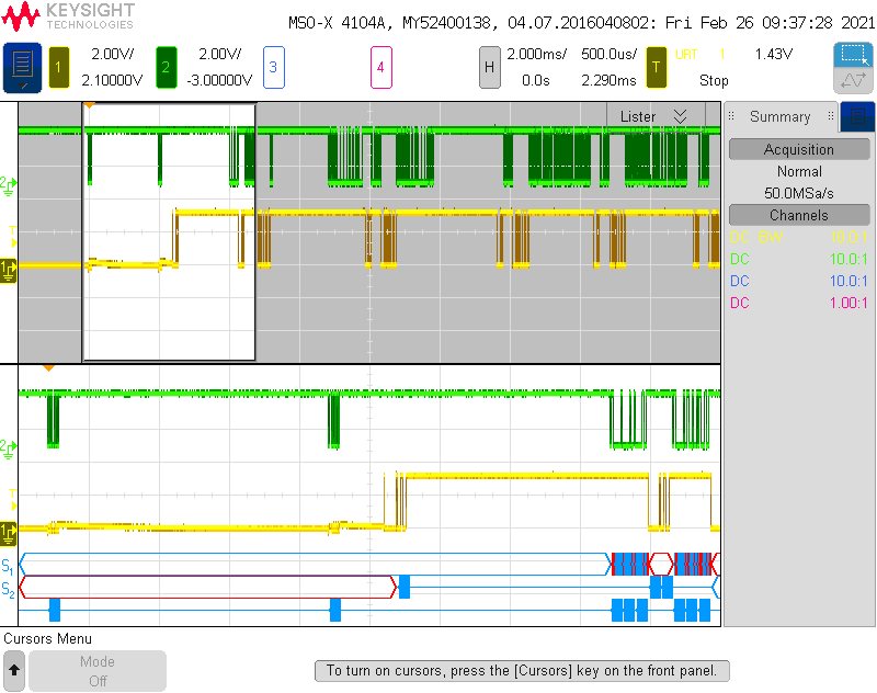

    Here are some scope captures of the issue:
    First, the V7 silicon with no delays between or after the autobaud bytes:
    Here's the V7 silicon with 2mS delays after each autobaud byte.  It's zoomed out so the decode doesn't read out bu you can see from the traces that the MCU bootloader ROM responds.  It also sucessfully programs.
    For completeness, here's the V6 silicon with no delays.
    Had this happened during my initial development I wouldn't have though much of adding the delay to make things happy.  I'm really just looking for some reasoning on why the silicon version has any affect on this.  I haven't been able to find anything documenting the timing requirements.  I suspect this is largely because not many people are running the bootloader from a host processor.
