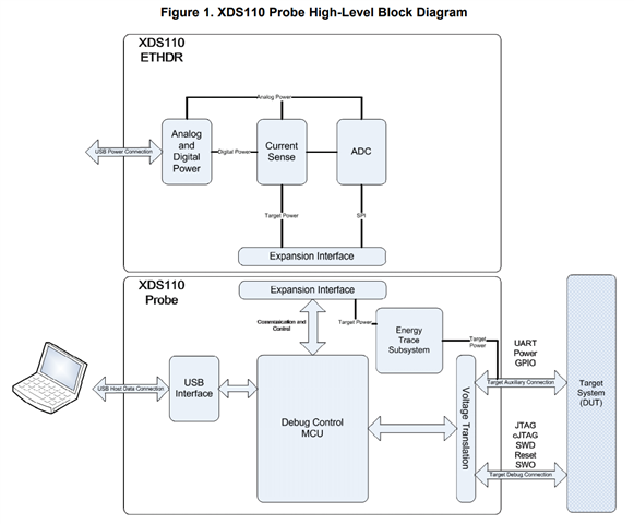

In order to make the current consumption measurement I would like to use the XDS110 Debug Probe + XDS110 Energy Trace HDR system as it supports the current range I need to observe (from 1 µA to 800 mA).
According to the datasheet of the XDS110 EnergyTrace HDR Debug Probe Add-On user's guide, it is possible to connect to the target device via different ways, for example through the GPIO connectivity, as shown right below here :
My concern is that I am not sure whether it would be possible to make the connection to my NB-IoT module. I will only need to use Energy Trace in standalone mode and not in debug mode, thus I was wondering if only by using the GPIO the measurements would be successful. In fact, the module does not present any JTAG interface and I would like to keep the external power source for the target device, without having to power the target through the XDS110.

  • Alberto,
    In the diagram the UART/POWER/GPIO label is showing that these connections are happening via the Target auxiliary Connection. That is done using the little breakout board that comes with the unit.
    In order for EnergyTrace to work the XDS110/HDR needs to be supplying power to the target.
