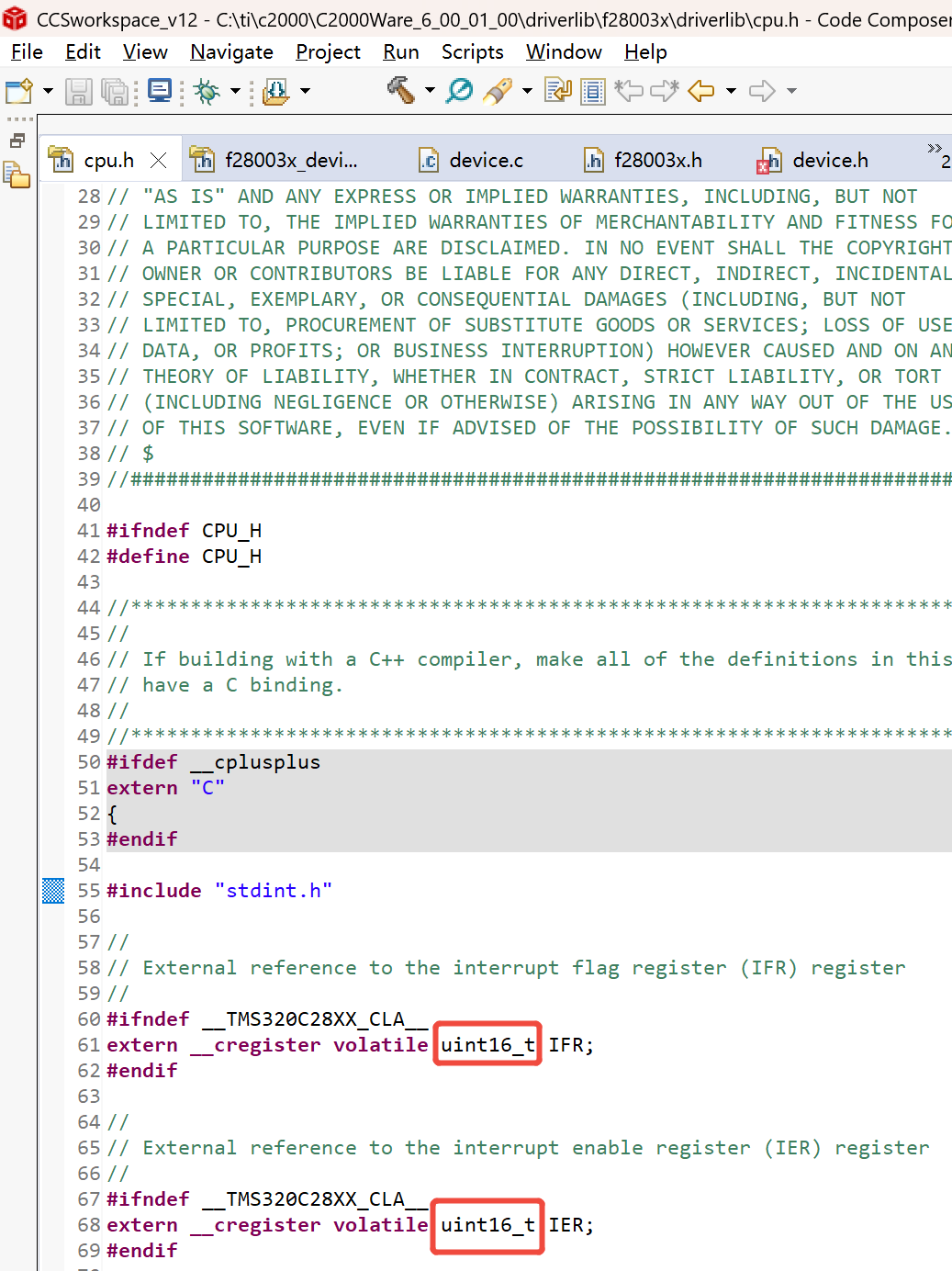

In my project, I used both bitfield and driverlib, and referenced their header files using relative paths, as shown below:
I found that when I upgraded the compiler version from 22.6.2 to 22.6.3, the project that could compile normally before started to have compilation errors.

"C:\ti\c2000\C2000Ware_6_00_01_00\driverlib\f28003x\driverlib\cpu.h", line 61: error #148: declaration is incompatible with "volatile unsigned int IFR" (declared at line 55 of "C:/ti/c2000/C2000Ware_6_00_01_00/device_support/f28003x/headers/include/f28003x_device.h")
"C:\ti\c2000\C2000Ware_6_00_01_00\driverlib\f28003x\driverlib\cpu.h", line 68: error #148: declaration is incompatible with "volatile unsigned int IER" (declared at line 56 of "C:/ti/c2000/C2000Ware_6_00_01_00/device_support/f28003x/headers/include/f28003x_device.h")

This is because in version 22.6.3, the definitions of uint16_t were changed from unsigned int to unsigned short. However, in C2000ware, the definition of Uint16 is still unsigned int. Therefore, my project throws an error when compiling source files with the following header file.
While int and short are equivalent in C2000, the compiler considers them to be of different types and reports errors.

  • Above issue was a result of the fix for https://sir.ext.ti.com/jira/browse/EXT_EP-12834
    An updated fix for EXT_EP-12834 will be made and can be tracked with EXT_EP-13044
    In the meantime, for 22.6.3.LTS and 25.11.0.LTS, below workarounds can be used:
    Use only consistent type definitions from stdint.h
    Or undo below fix from EXT_EP-12834 in include/machine/_types.h
    and then rebuild the RTS library using mklib.exe per spru514 user guide.
    #else
    typedef short __int16_t;
    typedef unsigned short __uint16_t;
    To instead have this:
    #else
    typedef int __int16_t;
    typedef unsigned int __uint16_t;
