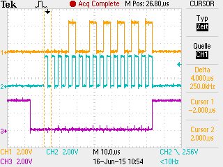

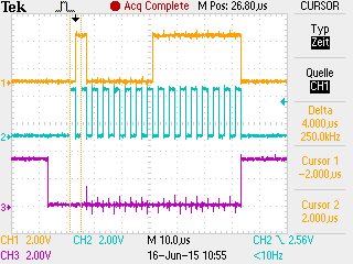

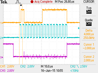

I am trying to communicate with a port expander (MAX7301AAX) via 4-wire SPI. Although I am absolutely sure to
send the right commands, I am not able to set a port.
My SPI configs are:
   SpibRegs.SPICCR.bit.SPISWRESET=0;  // Reset SPI
   SpibRegs.SPICCR.all=0x000F;        // CPOL = 0; 16bit mode //0x004F
   SpibRegs.SPICTL.all=0x000F;        // CPHA = 1; Master mode; TX enable, Interrupts disable //
   SpibRegs.SPISTS.all=0x0000;          // 00000: no receive overrun occured; no full words received/transmitted; transmit buffer not full;
   SpibRegs.SPIBRR.all=0x0063;        // 1100011: SPICLK = LSPCLK / 100 = 500 kHz
   SpibRegs.SPIFFTX.all=0xC022;       // 1100000000100010: reset fifo; enable interrupt; interrupt at 2 words or fewer Enable FIFO's
   SpibRegs.SPIFFRX.all=0x0022;       // 100010: enable interrupt; interrupt at two or more words
   SpibRegs.SPIFFCT.all=0x0002;          // : 2 clocks delay
   SpibRegs.SPIPRI.all=0x0010;          // free run
   SpibRegs.SPICCR.bit.SPISWRESET=1;  // Enable SPI
   SpibRegs.SPIFFTX.bit.TXFIFO=1;
   SpibRegs.SPIFFRX.bit.RXFIFORESET=1;
I also observed the DIN Pin with a oscilloscope but could not find anything wrong. I tried CPHA = 0 and CPHA = 1, without success.
