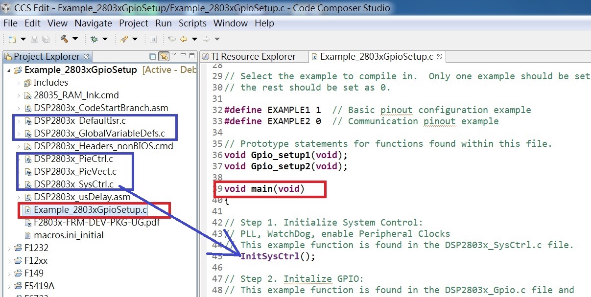

Hello
I just move from CCS4 to CCS5 and first touch F28035 of C2000.
I load project example from controlsuite as following.
But I still don’t know the whole process to create the project.
For example.
When and how and where to add the MACRO file of  DSP2803x_PieCtrl.c DSP2803x_SysCtrl.c
and so on.
About this project create process and related knowledge,
Do any CCS5 expert can introduce related document for me to study.
I have searched for project creation. But I get only standard and simple example.
THANKS
  • The files you mention are part of the header file support package for the F2803x device.  They contain source code, not macros.  For a step-by-step description of how to build a CCS project from scratch you may find it helpful to review the 1-day workshop materials on this page:
    http://processors.wiki.ti.com/index.php/C2000_Piccolo_One-Day_Workshop_Home_Page
    The structure of the device support files is described in the documentation which accompanies them.  If you have installed controlSUITE in the default location, a useful document can be found at:
    C:\ti\controlSUITE\device_support\f2803x\v130\doc
    To create a new project using the header files, you would follow a similar process to lab 1 in the workshop, then add files as described in section 2.5 of the document.
    I hope this helps.
    Richard
