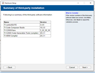

How can I change the folder name of C200Ware (C:\ti\c2000\C2000Ware_3_02_00_00) as I am having issues with Simulink embedded coder, due to the long path.
This is the error that I am getting when I compile which I believe is due to the path.
gmake: *** No rule to make target `C:/ti/c2000/C2000W~2/DEVICE~1/f2838x/common/include/driverlib.h', needed by `c2838xBoard_Realtime_Support.obj'.  Stop.
  • Hi Mike,
    I am assuming you have installed C2000ware SDK on your system. Can you check if you have this file at this location?
    What are compiler version and CCS version you are using? Can you send full log from Output window?

  • Please see attached list of installed 3rd party software tools and log from output window.
