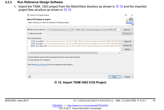

tidud29.pdf is the instruction of TDIM_1003, the download address is: www.ti.com/.../tidud29.pdf The 14th page of this document has: 3.2.2 Add Custom Hardware to MotorWare After installing the MotorWare and CCS software, follow these steps to add the files necessary to use MotorWare with the TIDM-1003 board:
1. Navigate to C:/ti/motorware/motorware_1_01_00_17/sw. All changes made for this TI Design are completed in "sw "subfolders.
2. Create a new HAL directory to hold the contents of the zip folder labeled "TIDM1003_sw_modules_hal_boards.zip," and copy the directory to "sw/modules/hal/boards." The folder should be named C:\ti\motorware\motorware_1_01_00_17 \sw\modules\hal\boards\TIDM_1003.
3. Create a new project directory to hold the contents of the zip folder labeled "TIDM1003_sw_solutions_instaspin_foc_boards.zip", and copy the directory to "sw/solutions/instaspin_foc/boards." The folder should be named C:\ti\motorware\motorware_1_01_00_17 \sw\solutions\instaspin_foc\boards\TIDM_1003.
               But TIDM_1003 is not found in the motorware_1_01_00_18 version we downloadedThe TIDM_1003 file package is still available in motorware_1_01_00_17 version. Can you send me the download address of motorware_1_01_00_17? And please help me find the file TIDM_1003.

  • Hi Luo,
    First of all, thank you for your reply. We downloaded the file you gave. After installation, we found that it is not the file we need. What we need is the TIDM_1003 CCS project source file inmotorware_1_01_00_17\sw\solutions\instaspin_foc\boards\TIDM_1003. Yes. Import CCS to run. We can’tfind it in the motorware_1_01_00_18 software we downloaded. For this reason, I hope you can find theTIDM_1003 project source file, as shown in the figure below.
    Thank you very much!
  • You can download and install the MotorWare V18 from this link http://www.ti.com/tool/motorware.
    And then exact the file to over write the "sw" folder in "C:\ti\motorware\motorware_1_01_00_18" as mentioned above, you might find the CCS project at the folder
    "C:\ti\motorware\motorware_1_01_00_18\sw\solutions\instaspin_foc\boards\TIDM_1003\f28x\f2802xF\projects\ccs5\proj_TIDM_1003"

  • Any error or warning message reported if the project is imported and compiled within CCS? If not, that means all of the files should be included.
    Customer/You should find the main source file in the folder "C:\ti\motorware\motorware_1_01_00_18\sw\solutions\instaspin_foc\src", and the module files in the related directory of the folder "C:\ti\motorware\motorware_1_01_00_18\sw\modules", and "C:\ti\motorware\motorware_1_01_00_18\sw\drivers".
