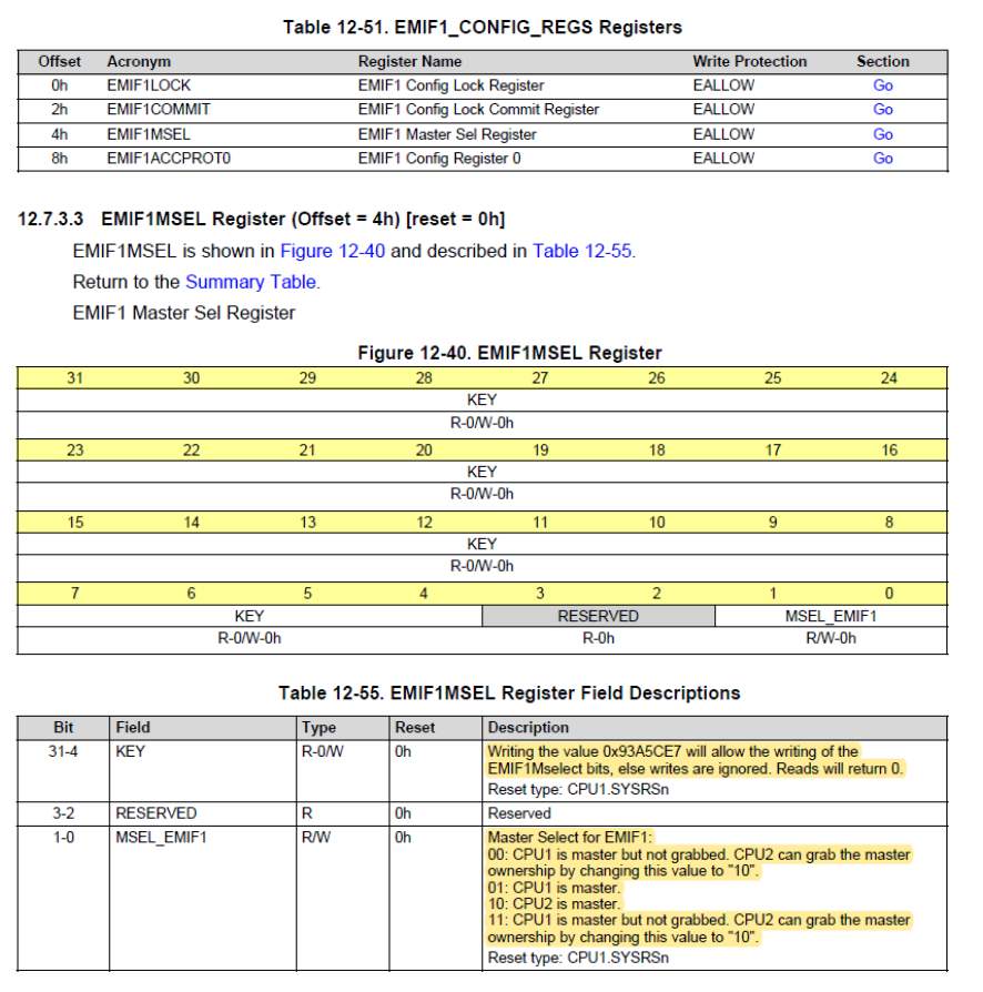

But we can't select CPU2 as master(Emif1ConfigRegs.EMIF1MSEL <- 0x93A5CE72).

     Yes. And I tried write the value(0x93A5CE72) with CCS@CPU1 direct, but not changed here(I expected it to turn 0x00000002).
     By the way, other patterns change as expected.
      Write Value -> Read Back Value
      0x93A5CE70  -> 0x00000000
      0x93A5CE71  -> 0x00000001
      0x93A5CE73  -> 0x00000003

            Emif1ConfigRegs.EMIF1MSEL.all = 0x93A5CE70 | cpu;    //    cpu is 1 or 2
        EDIS;

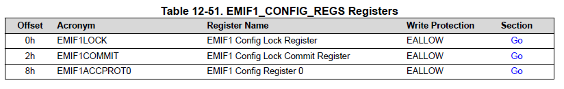

     We referenced spruii0b.
     But EMIF1MSEL register was deleted on spruii0c.
    Masahiro
    This is SEMAPHORE register and CPU can only grab it for for their own use. CPU1 can not grab ownership for CPU2. You need to do that from CPU2 code. Please try that and it should work.

    But, the documentation has some problem. I think.
