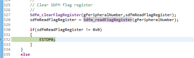

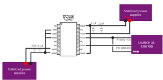

I am trying to connect the AMC1305M05 and LAUNCH XL-F28379D to check the offset voltage of the ADC.
The circuit diagram is as follows.

Every time I debug, the program stops at the following location.
When I checked the SDIFLG value, 1 was set in the MF1 to MF4 bits. It seems that communication is not correct.
Can you give me some advice?
    Based on your diagram, you are connecting clock to P.18/GPIO18/SD1_D2 and data to P.17/GPIO17/SD1_C1. If the diagram is accurate, then this connection is not correct. I am actually a little puzzled because I don't see a P.17 on the LAUNCHXL-F28379D quick start guide.
    I would suggest P.123/SD1_C1 and P.122/SD1_D1 OR P.124/SD1_D2 and P.125/SD1_C2 for your testing. Note you will need to enable SDFM_PIN_MUX_OPTION3 in the example code if you do use these pins.

  • Hi, Gus
    Thanks to your clear answer, I was able to receive the data. However, the external clock is not clear and it is uncertain whether the data is correct.

    The circuit configuration is considered as follows. It may need a terminating resistor, right?
    You can add termination resistors if you choose. During testing these can be replaced with 0-ohm resistors if not needed.
