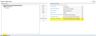

F28M35H52C: XDS110 - SC_ERR_PATH_BROKEN
Part Number: F28M35H52C
I'm picking up from where Jorge Caicedo left off on the linked related question.
I am, however, now running CCS 11.1 on macOS 12.1.
Today, I updated the XDS110 to the latest firmware and disconnected pin 10 (JTAG10) from pin 2 (JTAG14), as suggested by . In order to first power up the launchpad and only then power up the custom F28M35 board, I also disconnected pin 1 (JTAG10) from pin 5 (JTAG14), the 3v3 pin. I saw no changes in the results reported by Jorge Caicedo.
I would also like to correct a piece of information on the linked related question: the RESET pin has a 2k2 Ω pull-down (not pull-up) on our custom board.
My next step would be to do some reading on https://software-dl.ti.com/ccs/esd/documents/ccs_debugging_jtag_connectivity_issues.html and Troubleshooting.
