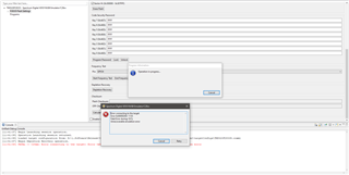

Whilst debugging (with break-points) a TMS320F28335 using a JTAG XDS510LC USB emulator, I get the following error
C28xx: Error occurred during flash operation: Timed out waiting for target to halt while executing FlashAPIInterface28335V2_10.out
C28xx: Error: Error 0x20000024/-1135 Severe Error during: Register, Execution,  Unrecoverable emulation error
C28xx: Failed to remove the debug state from the target before disconnecting.  There may still be breakpoint op-codes embedded in program memory.  It is recommended that you reset the emulator before you connect and reload your program before you continue debugging
C28xx: Error occurred during flash operation: Could not read 0x0000900E@Data: target is not connected
C28xx: Error occurred during flash operation: Could not write 0x00009009@Data: target is not connected
C28xx: Error occurred during flash operation: Could not write 0x00009008@Data: target is not connected
C28xx: Error occurred during flash operation: Failed to run target while trying to execute FlashAPIInterface28335V2_10.out
C28xx: Error occurred during flash operation: Could not write 0x08834@Program: target is not connected
C28xx: Flash Programmer: Error encountered when writing to flash memory
C28xx: File Loader: Memory write failed: Unknown error
The debuggin have been working (i.e break point where being hit) until the above messages appeared presumable during an erase cycle.
The DSP is now un-responsive (effectively bricked).
Please can you suggest
1. What might have happened
2. How to re-cover the DSP

    Thanks for getting back. I'm NOT able to connect neither through CCS nor Uniflash

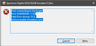

  • Hi Vamsi,
    I didn't deliberately interrupt the Erase operation. I just watched and eventually saw the error messages appear in the CCS Console (mentioned above).
    On subsequent debugging attempt with the same emulator, I see the error message below

  • Hi Vamsi,
    Thanks for the suggestion. However,
    1. Flash on this DSP is not programmed with a password.
    2. The JTAG emulator fails to detect the DSP. I am not sure how to perform your suggestions when the DSP is not detected at all.

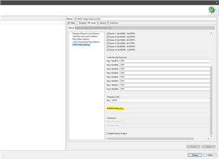

  • Hi Sam,
    Irrespective of whether CSM is implemented or not, if the depletion occurs, the CSM password locations may get invalid data.
    CCSv8 should have it; if not, you can use the latest CCSv11.
    Please note:  If you need further assistance on this, the flash domain expert of this device will be available after a week.  He is out of the office now.
    Thanks and regards,
    Vamsi
  • I am using CCS v8.3.1 and the following is what I see in the project Debug configuration -> F28335 Flash Setings
    There are no options under the Depletion Recovery section. Does it mean the JTAG emulator needs to establish comms with the DSP as a basic before one can use the Depletion Recovery?On pressing the Debug, i get the same error message as menioned in previous post.

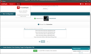

  • Update to the previous post.
    I have used UniFlash this time and able to see a Depletion Recovery button. Pressed it and gets the same error message as earlier

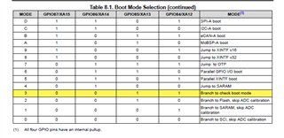

  • Sam,
    Thanks for the clarification, let's put the device in check boot mode and see if that resolves the connection issue.
    If this doesn't help, if you could double click on the ccxml of your target config and then "test" the connection and report back the dialogue box output that will help me determine if the issue is at the debugger or on the device.
    Matthew
  • Hi Matthew
    Just to make sure, I have understood it correctly, to put the device in to "check boot mode", I have to set the following GPIOs using an external wire.
    GPIO87 (pin #174) = Short to Dig Gnd (Vss)
    GPIO86 (pin #173) = Short to Dig Gnd (Vss)
    GPIO85 (pin #172) = Short to 3.3V (Vddio)
    GPIO84 (pin #169) = Short to 3.3V (Vddio)
    Please can you confirm the above.
    As requested, I will also do the "test" using the ccxml target config and revert to you.
  • Hi Matthew
    I have proceeded by putting external wires on the GPIOs (mentioned above) and is now able to CONNECT for the first time since the error.
    With the DSP in "check boot mode", I read the contents of the memory location 0x33FFF8 to 0x33FFFF as suggusted in your earlier post. As you/Vamsi had suspected, they are all 0x0000. Also, the message in the console suggests the device is locked. See below
    As the picure above doesn't show the complete console message, I have put a copy below.
    C28xx: GEL Output:
    ADC Calibration not complete, check if device is unlocked and recalibrate.C28xx: Flash Programmer: Warning: The configured device (TMS320F28335), does not match the detected device (). Flash Programming operations could be affected. Please consider modifying your target configuration file.
    C28xx: GEL Output:

  • Sam,
    With regards to #1 and #4 this is both tied to the device being locked.  Both the PARTID and the ADC Calibration codes exist in secure memory, so if the device is locked CCS will read back all 0x0000 at both locations and give this error.  If you were intentionally using the CSM module this wouldn't effect the operation of the device in a system.
    For #2 since this was an unintentional program of the CSM we don't know the values that got programmed.  Because of this we have no way to unlock it.  The only solution would be to replace the device.
    For #3, this can be a result of an interruption of the erase or program process of the device.  This could be either from a power fault during the flash operation or XRSn/reset getting forced during the flash operation.  The flash API will take care of the watchdog/other ISRs so this should not be the reason this happened.  There could also be a potential if the JTAG connection were interrupted during the loading of flash from CCS.
    In terms of avoidance, assuming we don't know the cause of either a power fault or external XRSn driving low, i.e. there is potential high noise environment, JTAG stability; there are some keep outs we can use to safeguard this a bit more.
    As shown below the CSM passwords are in the main flash array, and part of Sector A.  If you have spare flash memory in your application I would avoid using Sector A, as this will prevent any interruption of the flash programmation from happening to Sector A.  This device also uses balanced sectors, as such Sector H can influence Sector A(and vice versa) so I would also limit my use of that sector if possible.
    If your memory usage is such that you need the full flash addresses, I would try and limit how often Sectors A and H need to be re-programmed(i.e. put static tables in there, etc).
    From a CCS implementation if you open the Flash Tools, you can actively deselect which sectors are erased when the code is loaded, if you have not used A/H you should deselect them so they they won't be mass erased on every load.

  • Thanks for the instructions.
    My current version of UniFlash v3.4.1 doesn't seem to have the Memory option (mentioned above).
    If I update UniFlash to the latest v7.2.0, it fails to recognize the JTAG XDS510LC USB emulator I have.
    Which UniFlash version has both of the above?
