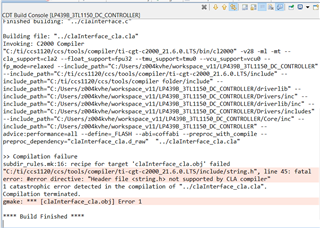

Hello all,
I want to use some features of CLA on my 320F280049C controller. I have tried cla_ex5_adc_just_in_time example code from CCSware_4_01. Now I want use some part of this code in my application code(GPIO toggle). The modified program get compile and debug successfully but LED won't toggle. I have also given the right path cla linker file. I have used LS0-program LS1,LS2-data ram of CLA but Memory allocation shows 0% after build project. Is there any settings to enable CLA to compile the program. Kindly find the attached images for the reference.
